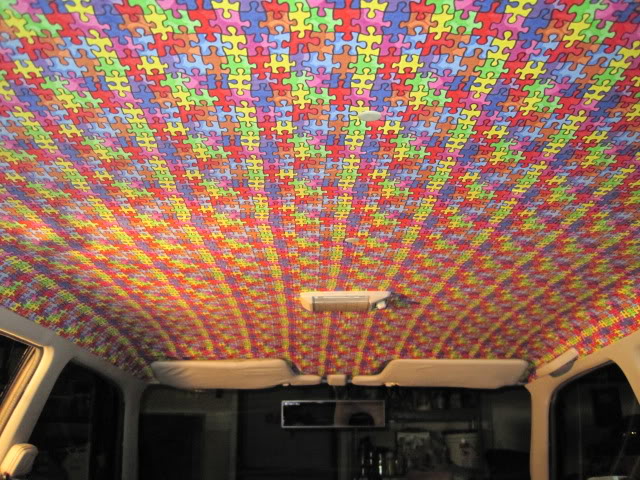

    Took me three times to get the headliner to stick, but I'm pretty damn happy with how this turned out...

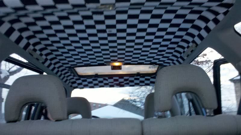

  • My headliner i did a while back hahaha

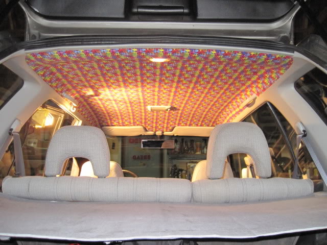

    i used some extra strength spray adhesive too but it wasnt strong enough cuz its drooping in places now so ill have to redo hopefully walmart still has the same fabric left
    while i was at it i did my rear speaker pods too

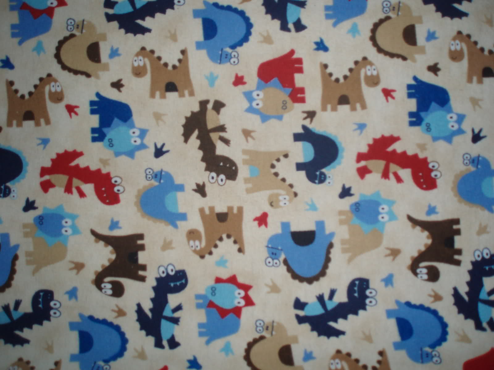

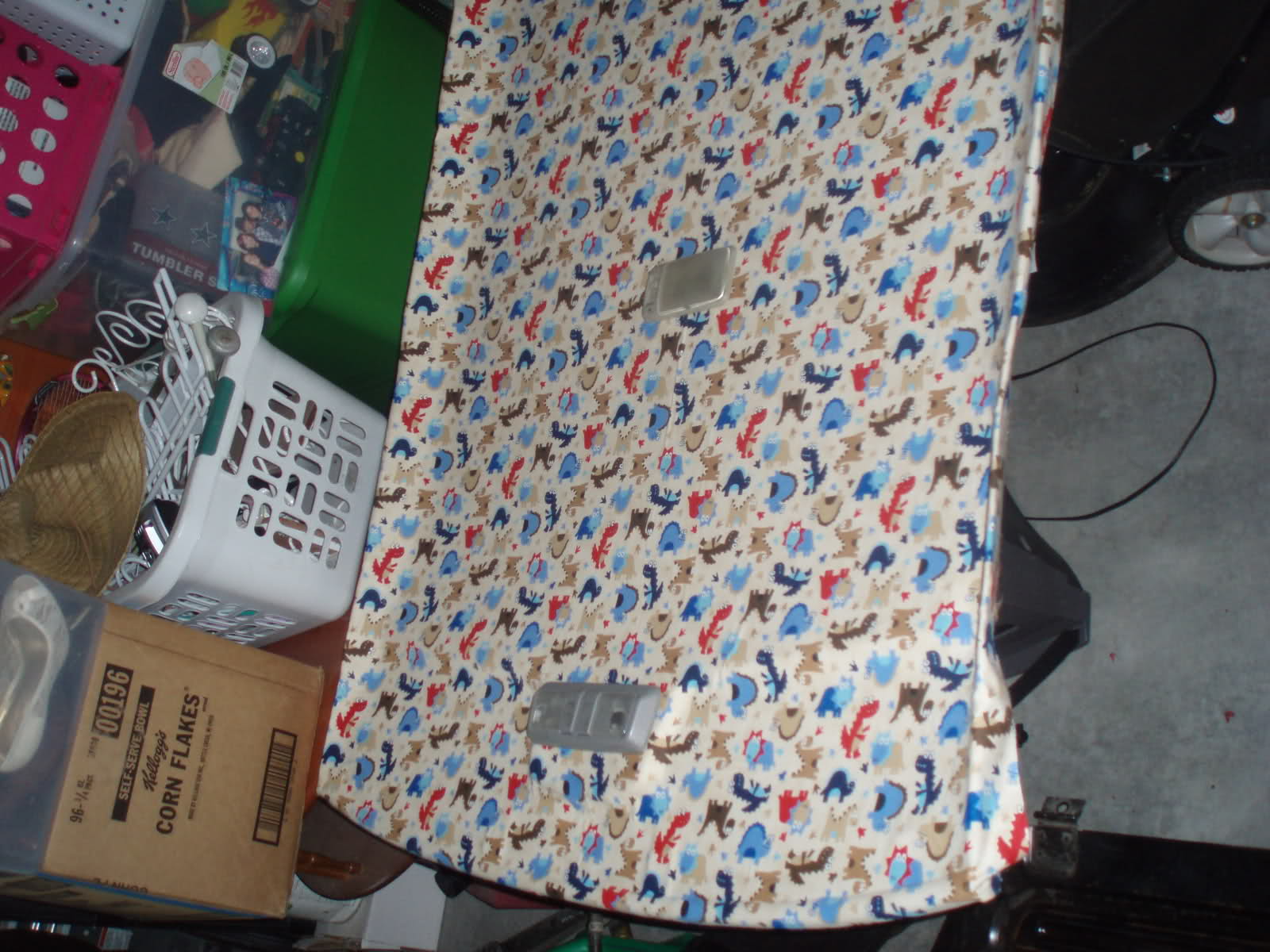

    It looks so good that I have been looking at fabric online for the last 2 hours. What the fuck is wrong with me? Let us leave that question unanswered. I found a pretty good cheap online fabric supplier. http://www.craftconn.com They even sell so-called "fat quarters" HAHA! Unfortunately it is just a new method they have devised for measuring and selling fabric.
    Here's some examples:
    Or you can go here: http://www.distinctivefabric.com and get stuff like this:
    Now everybody go make a custom headliner but don't use the green dinosaurs in the jungle one that shit is mine!
