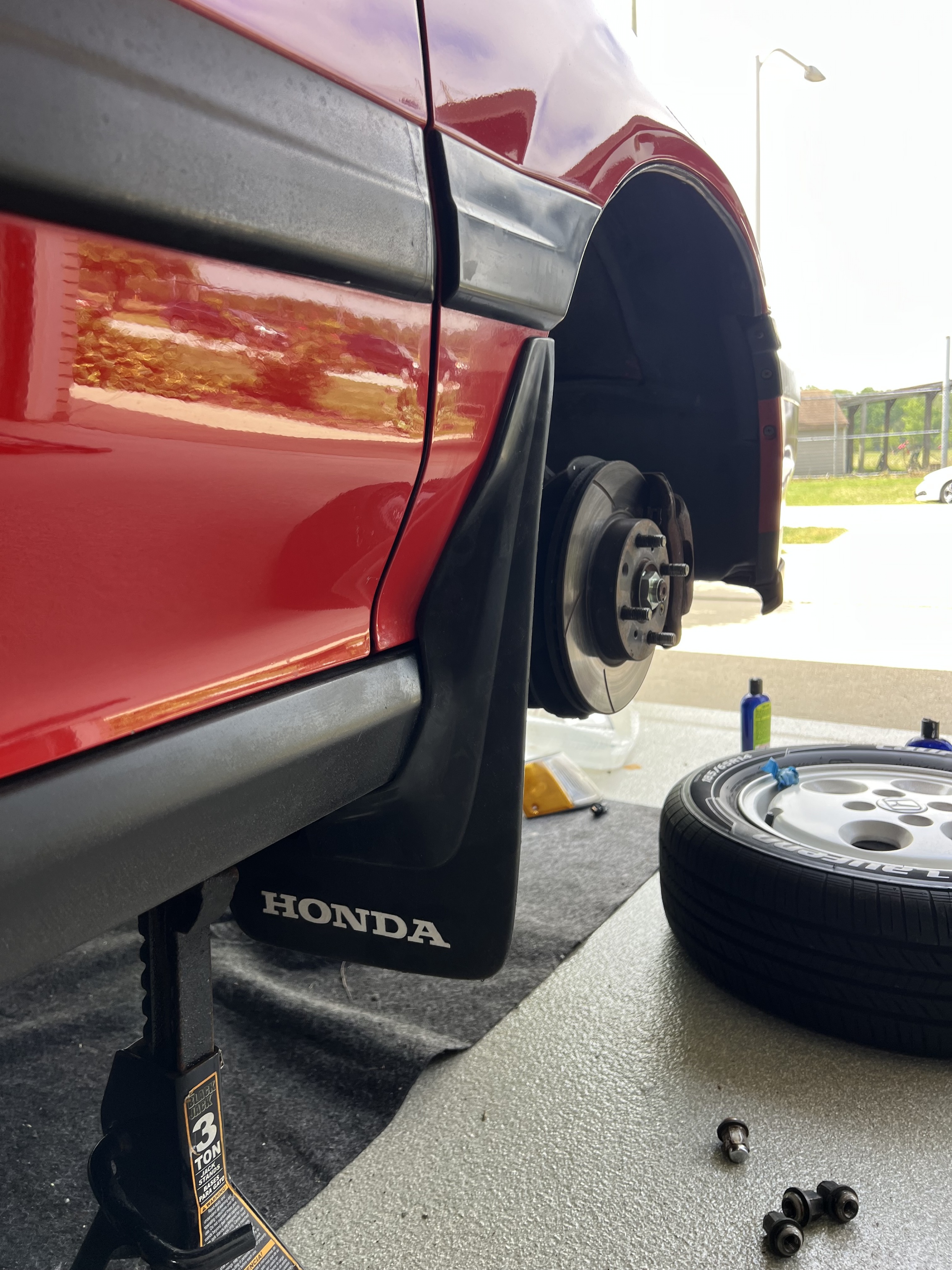

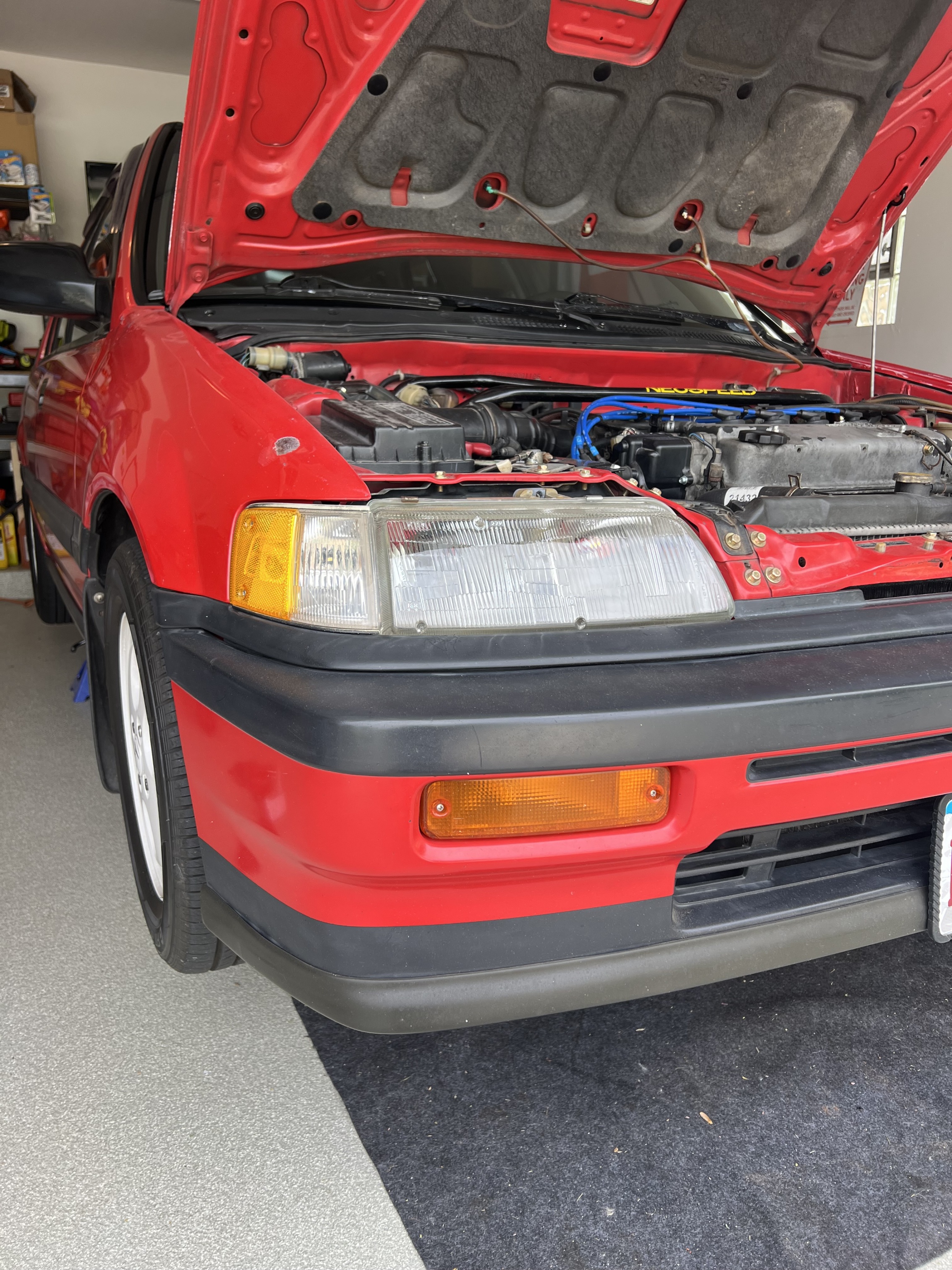

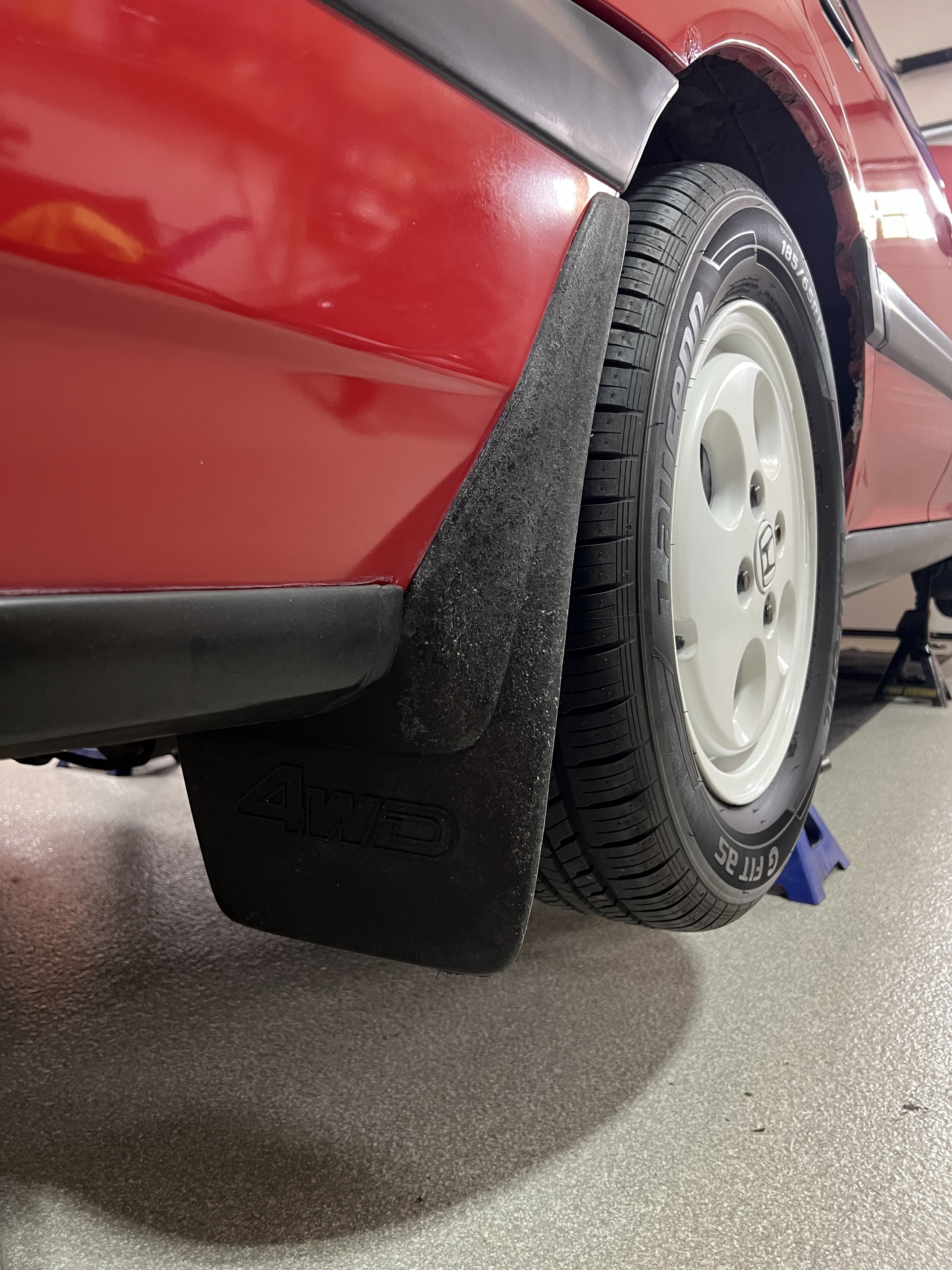

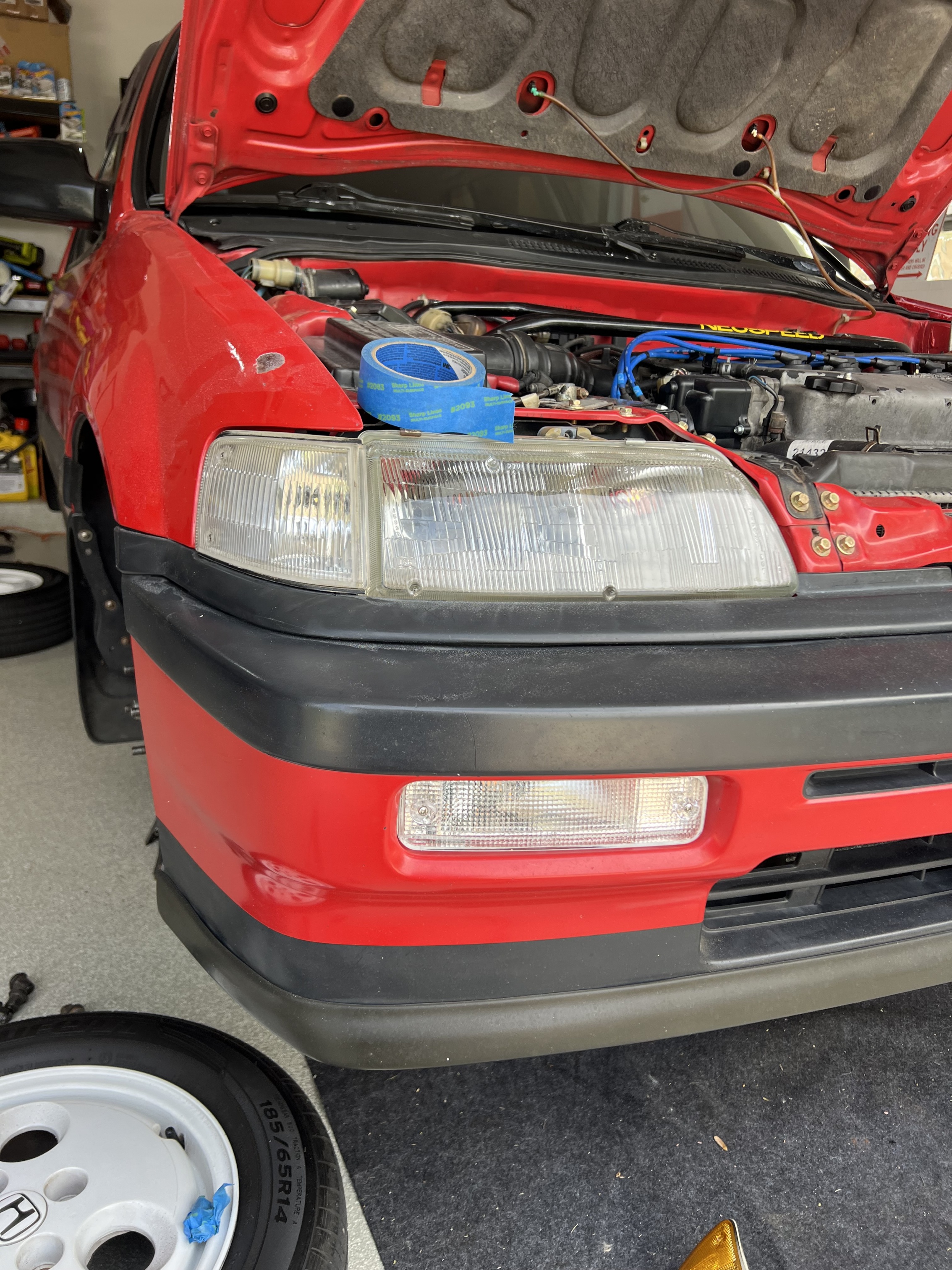

    I recently installed my front clear corner lights, clear front bumper lights, replaced new to me mud guards also painted the letters white, as you can see before and after photos

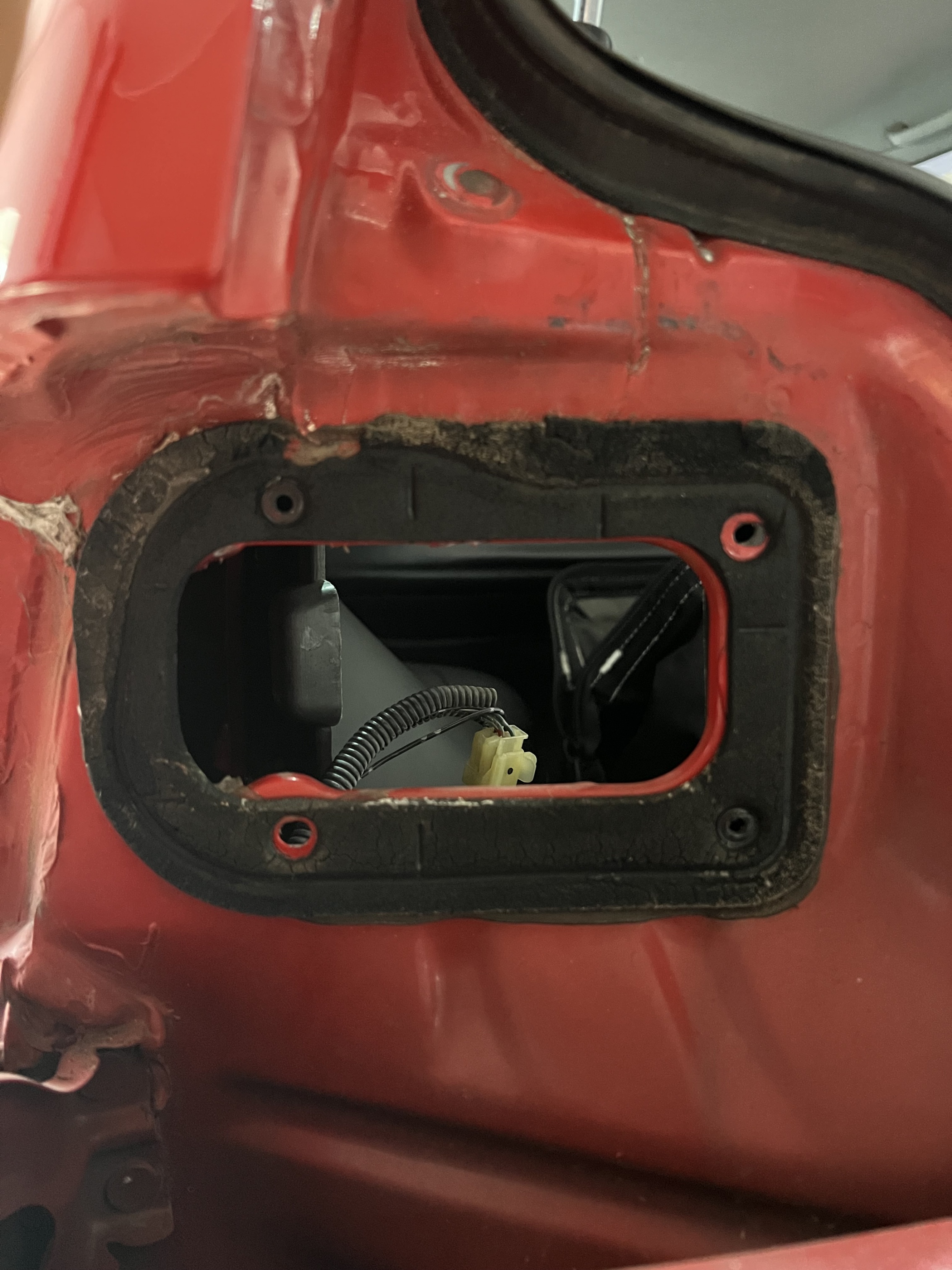

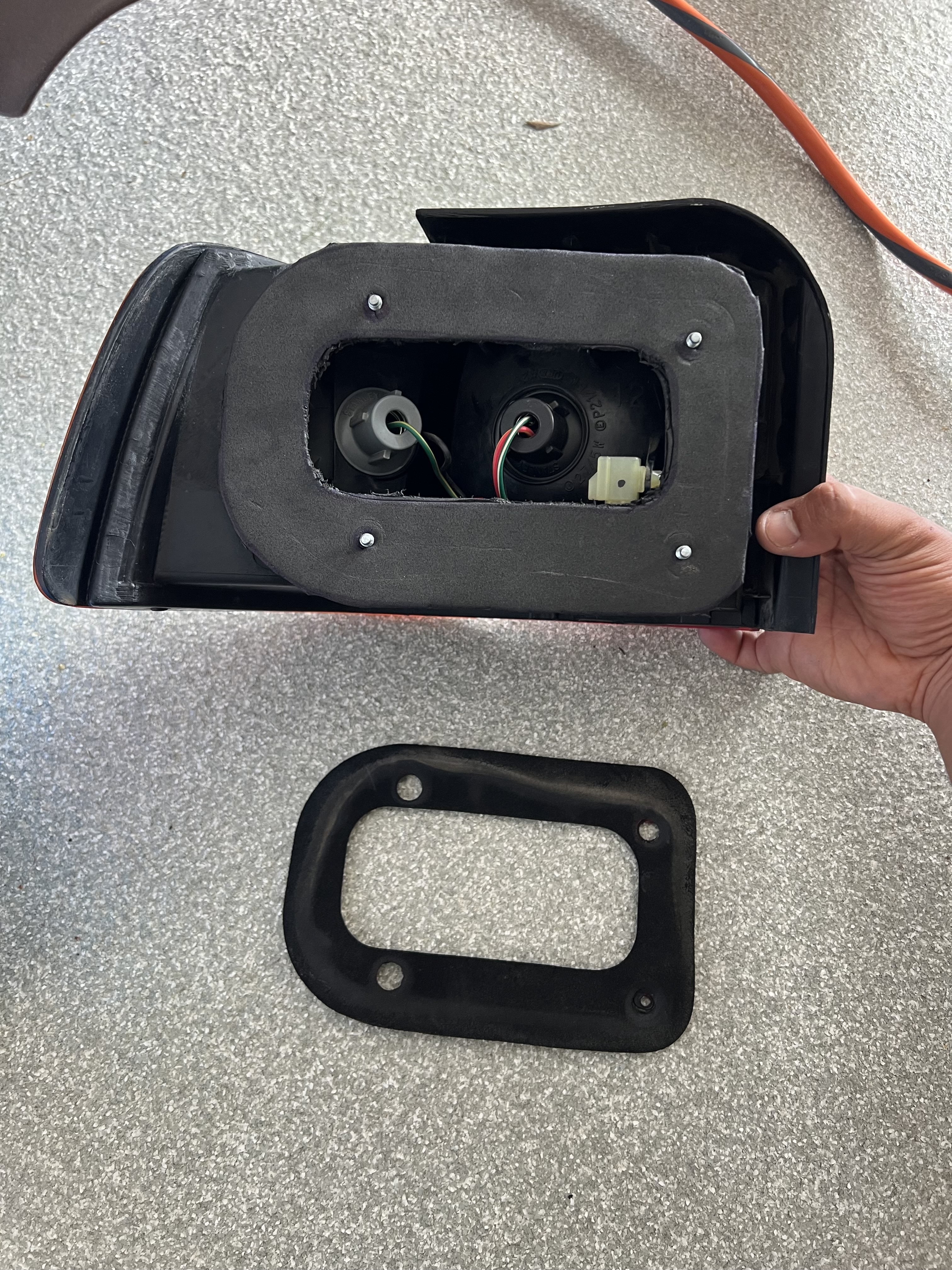

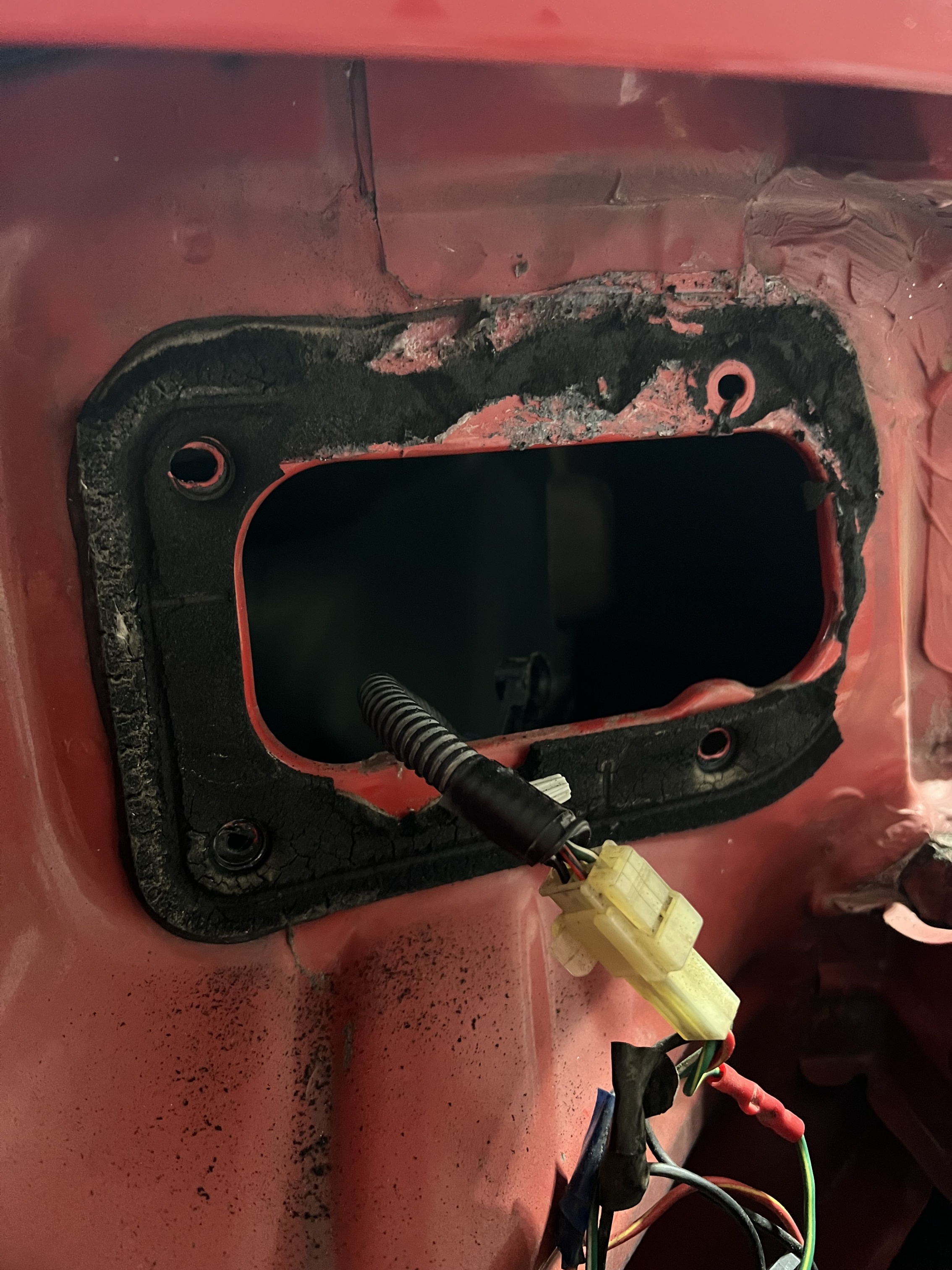

    Whoever owned this wagon before me, used some type of adhesive or silicone on the rear taillight gaskets to stick to the chassis, that was a real pain to remove because the taillights were stuck in place
    so I had to take a heat gun to loosen up the adhesive/silicone to pry out the taillights, used a metal scraper to scrape off that gunk off and the old gasket too

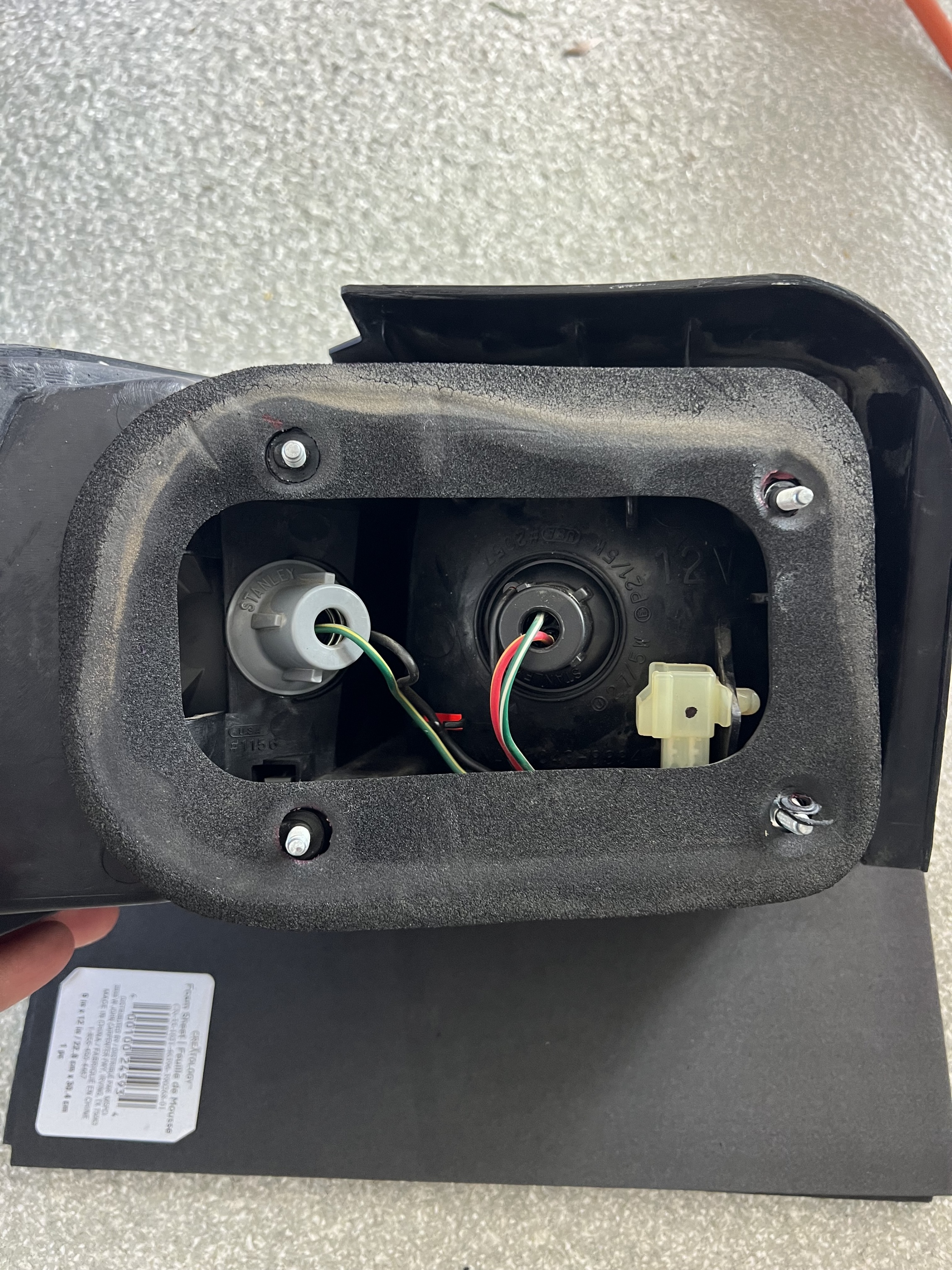

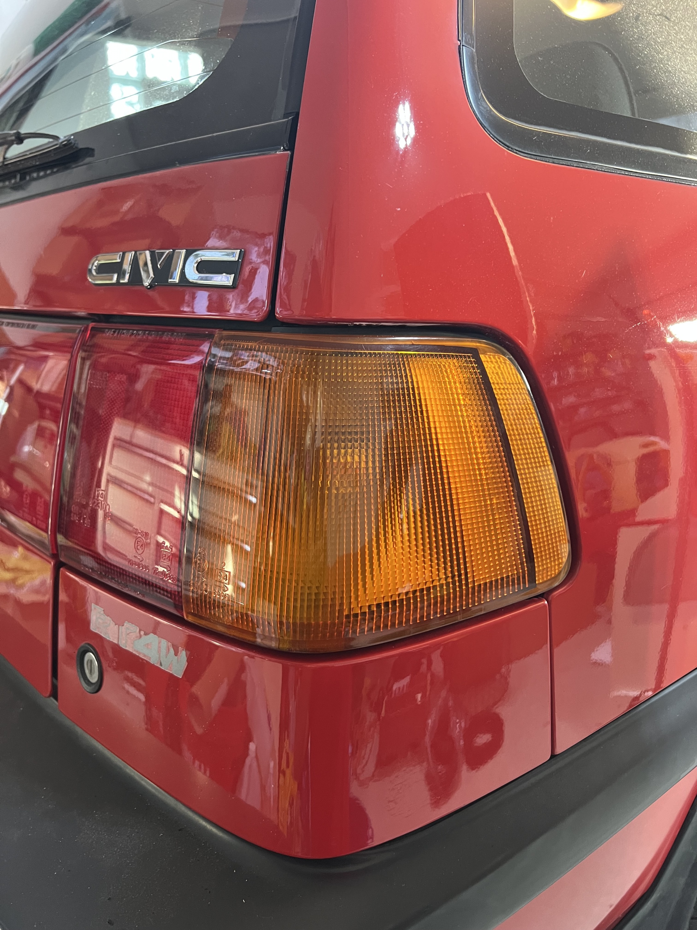

    So of course, the old gaskets were destroyed so I had to make my own. Good thing my JDM taillights came with very good gaskets so I could trace off them to make new ones. They’re slightly thicker but not by much. They came out decent.
