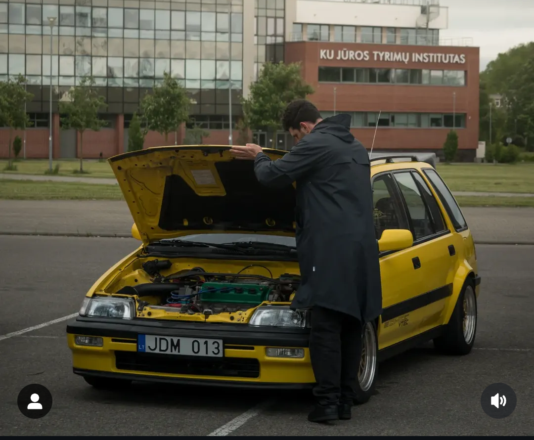

    The winter is over, but wagon works seem to keep piling on!
    I have done some fixes that I deemed necessary to make the wagon more reliable:
    • I think I absolutely resolved my leaking engine oil problem with swapping a vtec gasket.
    • I bought a new power steering hose that was rubbing on to the belt.
    • Got a brand new alternator, and it was such a pain to install, I needed to take off the axles!
    • Swapped the powersteering fluid, belt and cleaned the PS pump while I was in there.
    • Made a new grounding wire in engine bay
    Furthermore, I had an issue with the cheap front upper suspension arms so I decided to buy a proper hardrace kit, since it resolved all my issues in the rear of the wagon.
    These are very sturdy in comparison to the $99 ones and probably will last much longer.

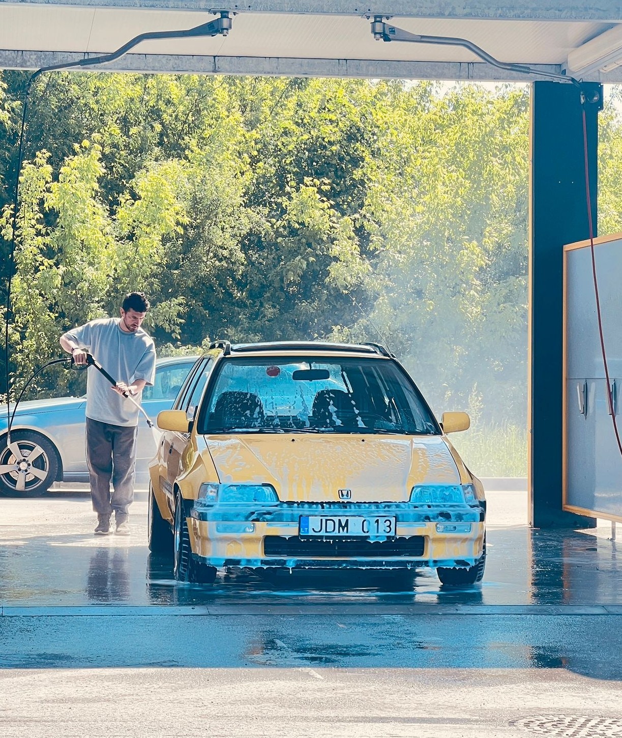

    Onto some good news - our local JDM club went for a 200 mile drive to a neighboring countries capital for a big car show. However, one of our honda's decided to lose spark
    Being who we are of course we bought new ignition coil for the distributor, fixed the car and got to the car meet a few hours late.

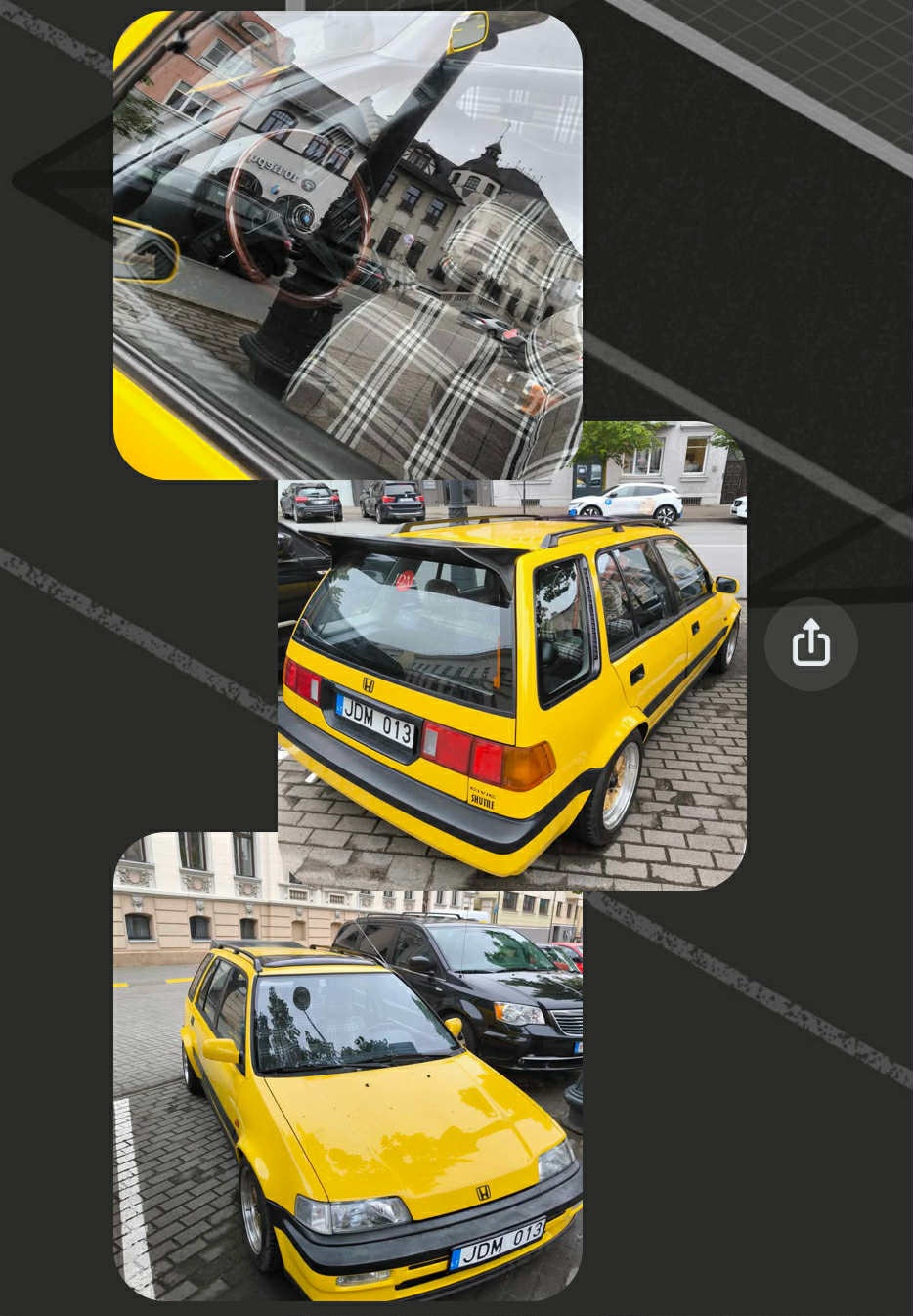

    Here are some pictures from the show:
    Even if we were late and had problems getting there AND cleaning our cars, I think it still turned out quite well!

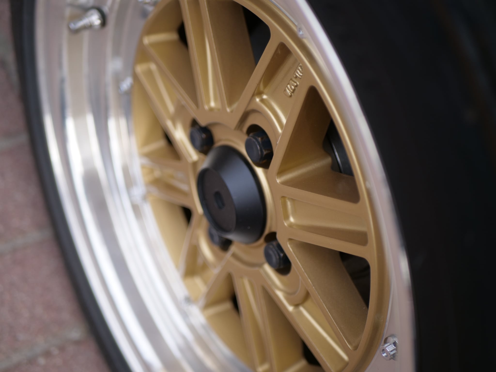

    New week new work done to the wagon!
    I did get new wheels that are a perfect fit in size, and finally the tires seem to fit nicely, since there are no 215-225 tires for 8js.
    THe wheels I got are 7.5J ET20 15s JR31:
    My wagon learning to fly, or swapping wheels.
    Not the best quality pictures that would do it justice, but I am sure I will get better shots from upcoming events.
    I do have to say the car now looks more fun/sporty, the best comparison I can give is it looks like it is wearing fresh Nike sneakers with white base.
    Also, I did an alignment to make the more stable for highway, I went from -2 front to -1.5 and from -1.5 back to -1.
    The difference it makes with the new more narrow wheels and less camber is just great, the car is much more planted and less jittery.
    This means I can blast normal euro highway speeds with confidence.
    Oh just before this I got the hardrace camber arms installed and it changed caster a bit, but I am not sure I can notice it, or if it even makes a difference.
    I also adjusted the intake filter for less rub, and I ordered all the small bits and pieces.
    Lastly, I made the orders for the sound system, and here is the latest 90s looking release of the Blaupunkt head unit that is very period correct AND has all the latest tech in it. Not cheap at around $450, but it is just so so cool. I cannot wait to get all of it together.
    I also went on a scavenger hunt to get the smaller part of our top cargo area cover, which I plan on using as a place to put on standing speakers that also look period correct.

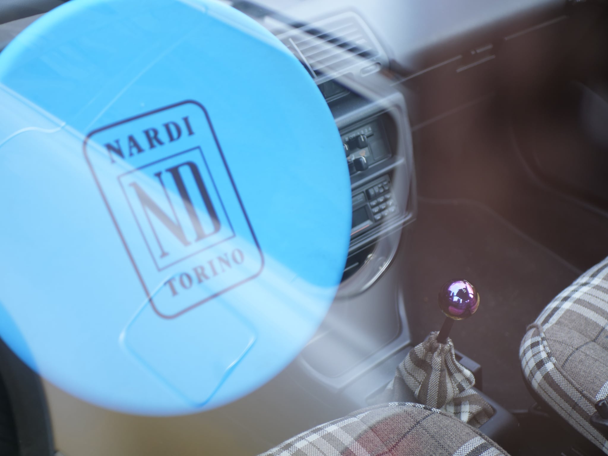

    Got a new NRG heavy shift knob - it feels just right, a bit chonky and solid. The only problem is it gets very hot during the summer.

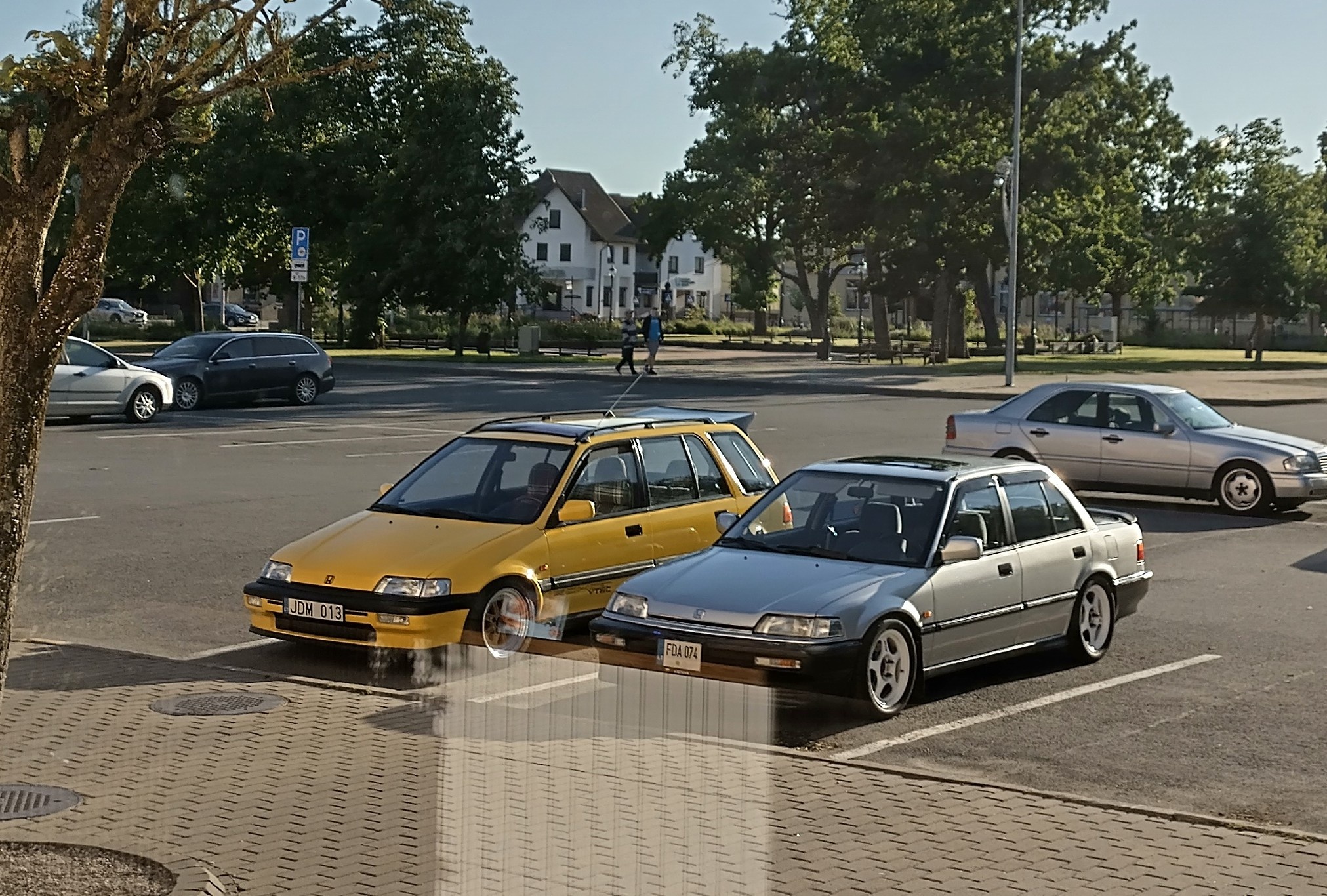

    Best thing about this summer so far was going to one of the best car culture events in the nation called Chill'n'Grill that is like a mini Pebble beach style weekend in a nice location.
    We went there as 4 EF owners. Here are the pictures of the event:

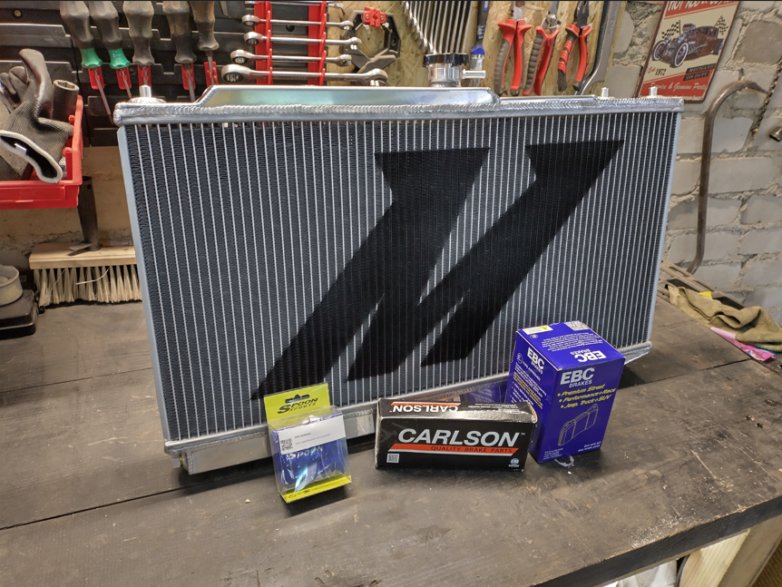

    I got a bunch of new parts for the wagon, but not all of them got installed just yet:

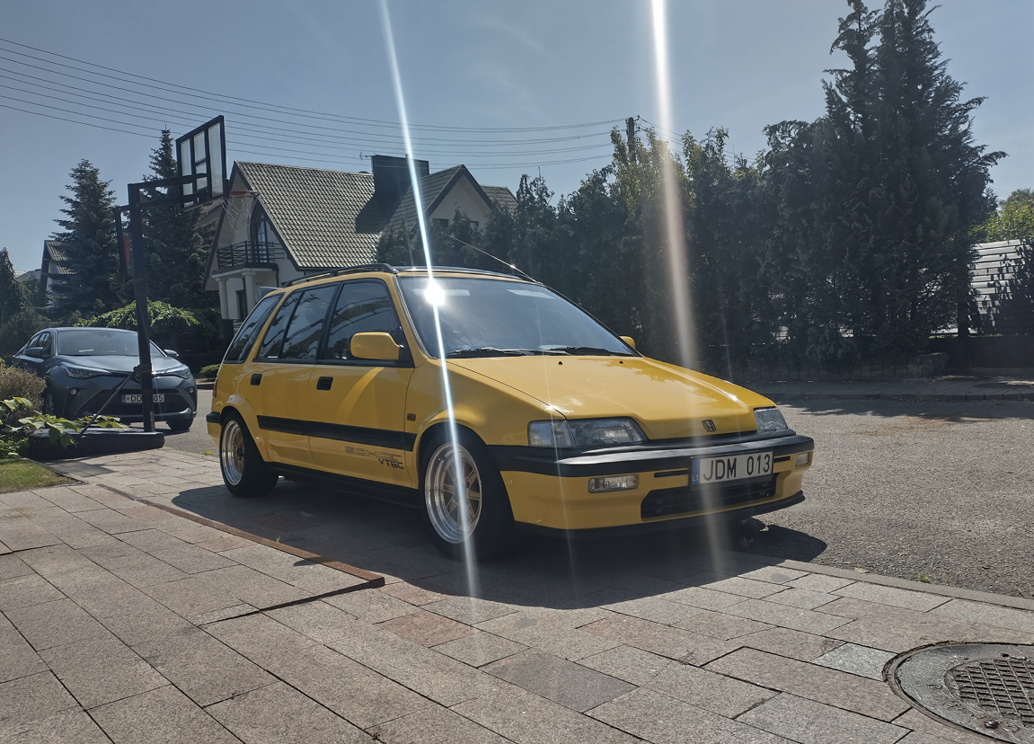

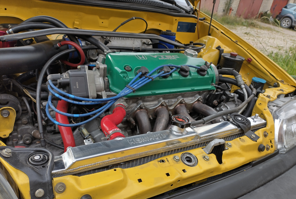

    Summer is here and so is an update!
    • Front window mechanisms got white lithium grease
    • Added missing clips and bolts to front door panel
    • Got 2x new OEM Honda emblems and painted them matt black

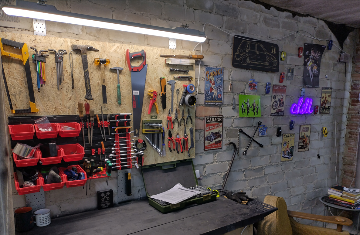

    • Moved to a new garage and made a ramp for my lowered wagon
    • Got exhaust manifold from Jacob made by PLM 4-1 (Had to be modified to clear power steering)
    • Got custom made 2.5" stainless steel exhaust from manifold with 2x mufflers and a resonator
    • Tucked the exhaust as close to the chassis as possible
    • Modified the power steering bracket and changed the belt to fit
    • Got a wonderful car cover that fits
    And here is the gang watching Initial D!
  • Vtec_ShuttleVtec_Shuttle Wagonist
    edited July 2024
    Congratulations on the new garage, those header/exhaust look real real nice. Very smart to tuck the exhaust as high as it can go, I did the same. The painted emblems go very well. Initial D is always great to watch

    And of course some pictures of the garage itself, it is rented BUT I have made it a spot to hang when things get tough.

    Since I had a few days to work on stuff in my garage I decided to rebuild my shifter.
    I removed the slack that it had going from side to side, front to back, and even when twisting it.
    I even had to make a bronze insert since one of them was missing inside the cable.
    This has made a TREMENDOUS difference, I highly recommend doing this if you got shifter slack.
    Here to remove the slack thanks to Jacobs ideas I had a friend of mine weld a thin metal plate that I used for measuring valve clearances.
    Here I had to squeeze the sides of the metal to make it so that the plastic cube would slide, but with friction.
    I painted the crusty looking metal and disassembled the whole thing.
    Also, all the things got lubed up with violet-blue looking goo.
    Here is the difficult bit - making the damned insert to fit inside the shifter cable.
    And here it is finished!

    Here are a few pictures from recent trips:
    Checking the stock wagon height of a friends Shuttle.
    Getting the miles in during sunny days for friends engine break-in procedure.

    Here are the results with new exhaust + manifold and two different intakes.
    Blue line - R2 motorsport whale penis intake with huge filter, we get more torque at low rpms for a bit.
    Greenish line - regular 3' pipe with smaller filter, we get more power for longer at high/usable rpms.
    Over all, we got ~170hp at the crank and around 179nm, however we did not rev the thing higher, the limiter is around 7600-7800.
    Since the power is right at the limit, I know it is not usable there, and I might need to look into making the engine stronger and able to go up to 8200 or so.
    I am happy that it is still very healthy and working as it should.
    I am not happy that the shiny carbon pipe did not perform better then simple one.
    Here is the lower performer, but looks good.

    Update time!
    I've been daily driving my Shuttle this summer for quite a while without any significant problems. However, I am planning a big trip to mountains in south of Poland.
    So I decided to swap my 10 year old brake pads to new EBC redstuff ones, as well as replace my half size custom radiator to a full size mishimoto one. The only problem is the hood is slightly touching the cap, but it does close. So it should be safe to drive like that.
