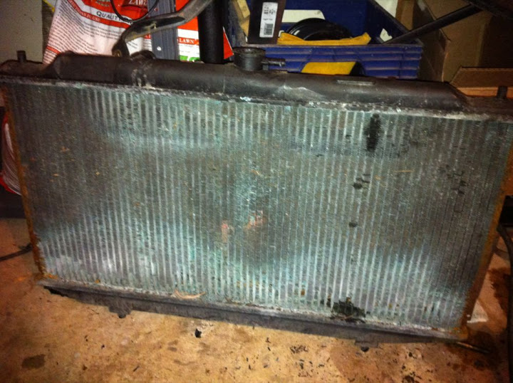

Radiator is in poor shape and will be replaced

Cyl head is back on, though the timing belt I bought is too long, so I need another one. New radiator is in, headlights are out, most bolts have been broken loose and re-tightned. Oil line has been added to a T on the firewall for the oil pressure gauge sender. Suspension is in progress, waiting for new adjusting rings from Ground Control, as the old ones has seized locking screws, so I cut them off. I have replaced all of the wheel bearings and ball joints, and had to replace one upper control arm as well.

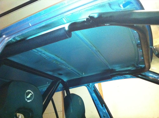

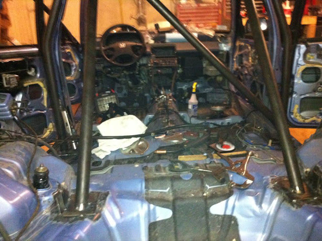

I've started to cut up the dash to fit the roll cage. We got the race seats, now I need to fab up some mounts to bolt them to the stock rails, as our drivers height is different enough that they need to adjust.

Roll cage is being built this weekend! After this weekend, there should be very little left to do. I'll be tired of welding at that point.
