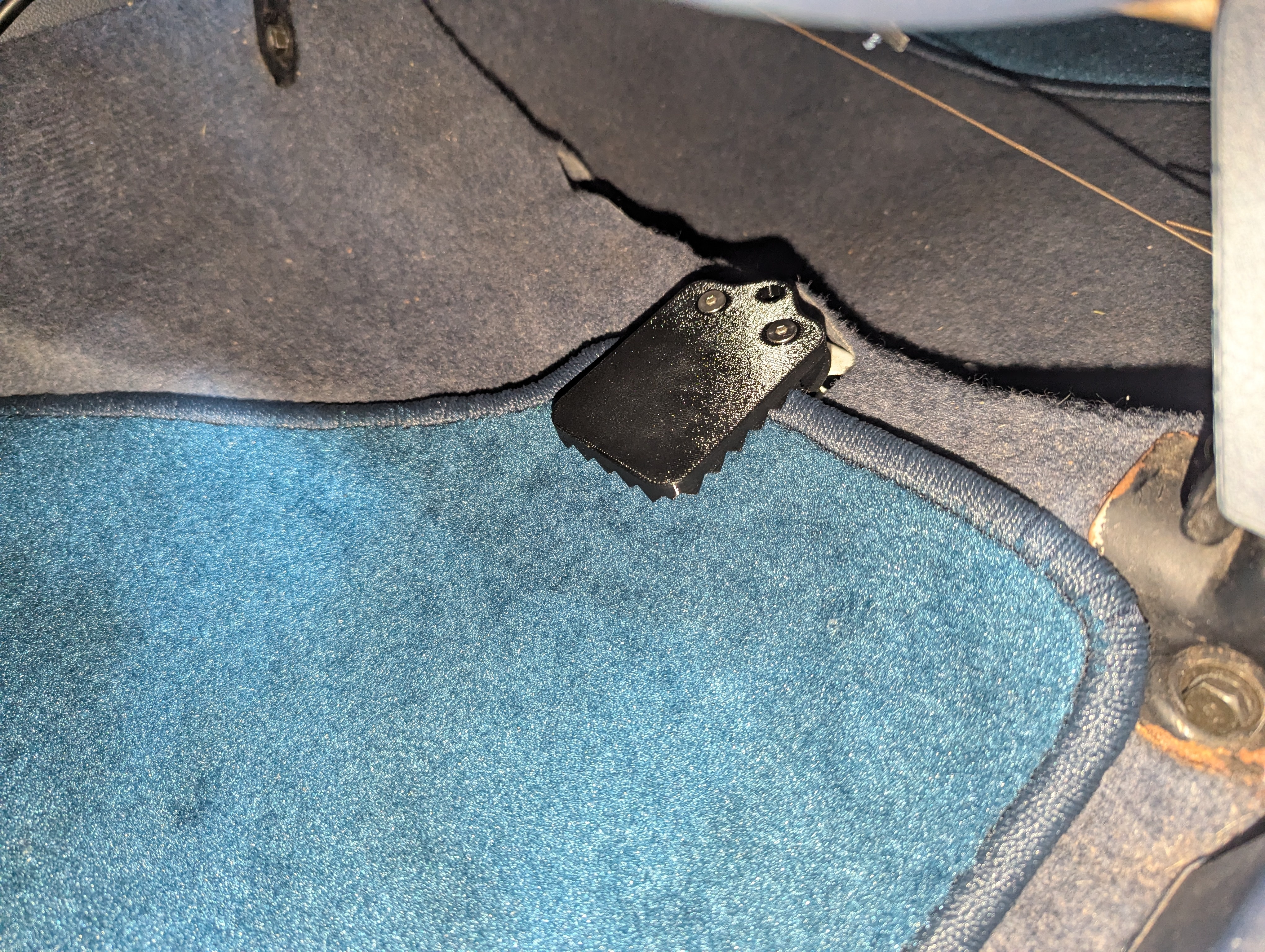

- 3D printed Carpet Holder to prevent carpet from sliding forward and hitting clutch

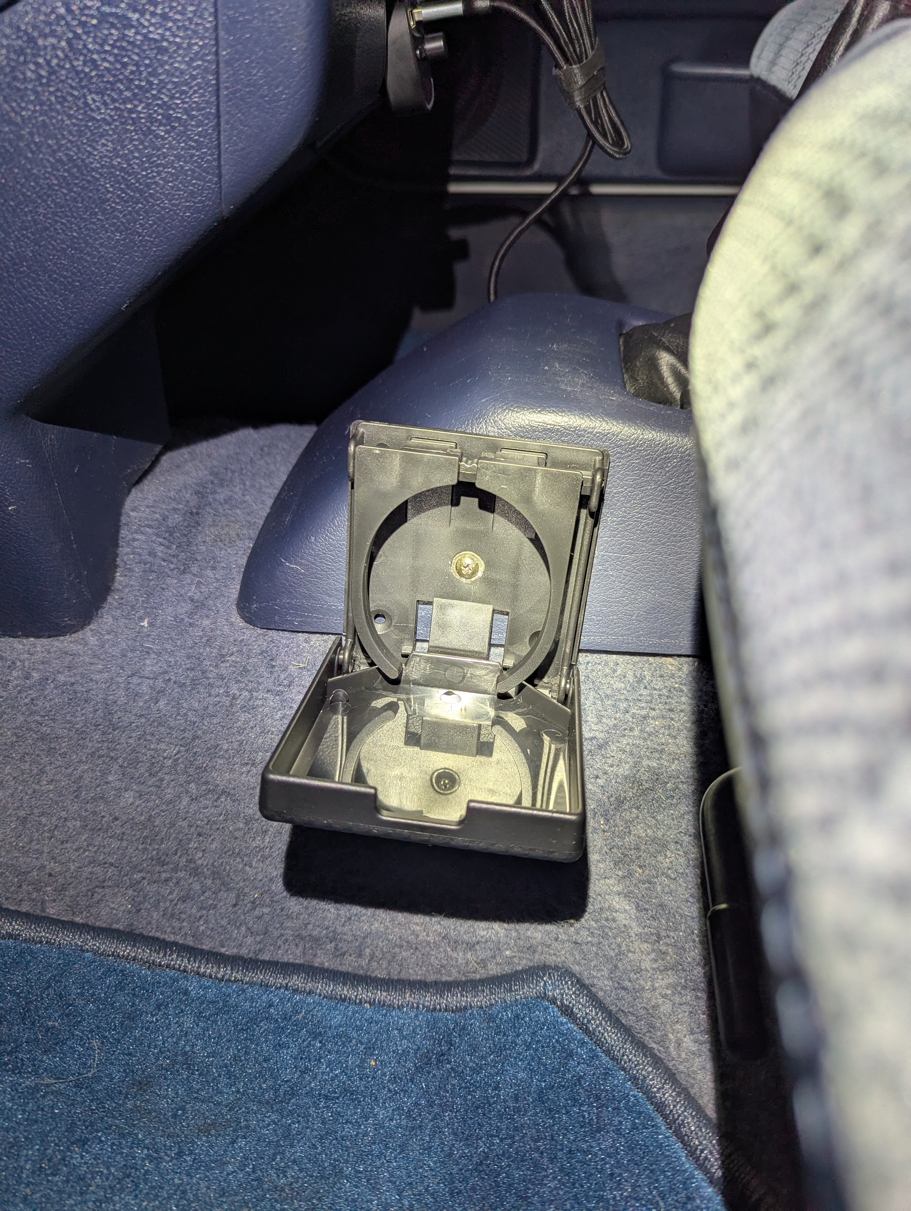

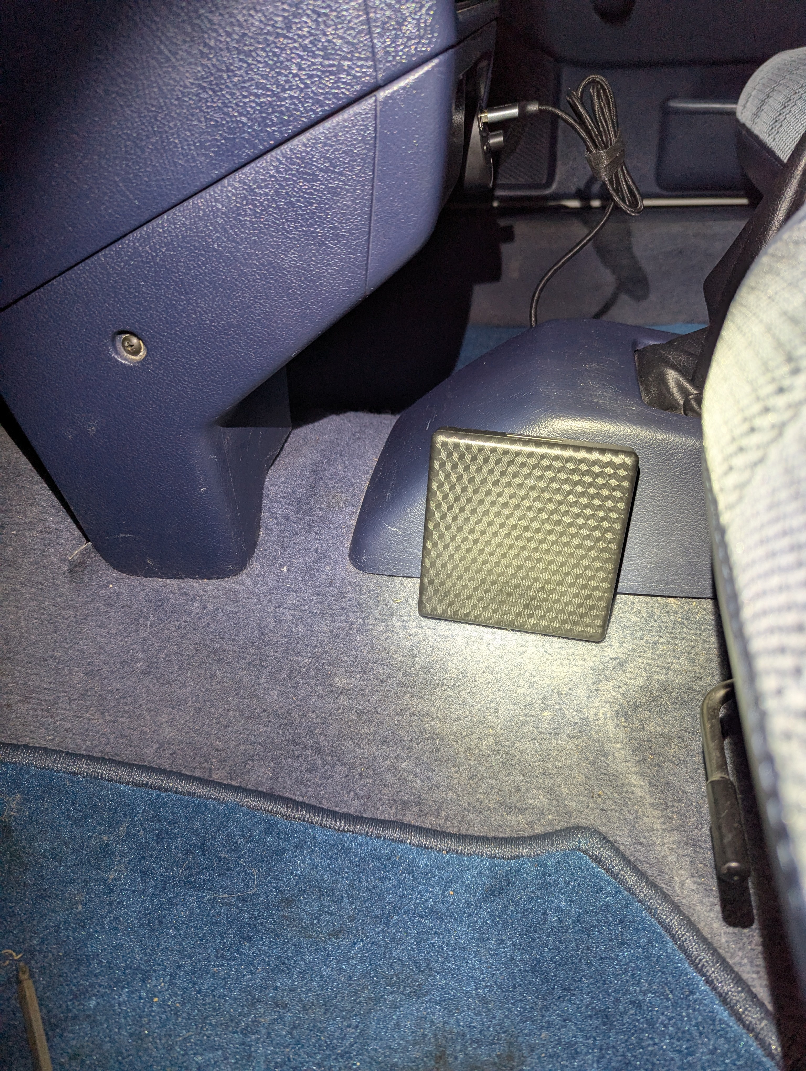

    • these cup holders are amazing like they were tailor made for this car, just single screw holds eveything together, the bottom edge lines up perfectly with the carpet edge and holds everything from rotating and loosening.

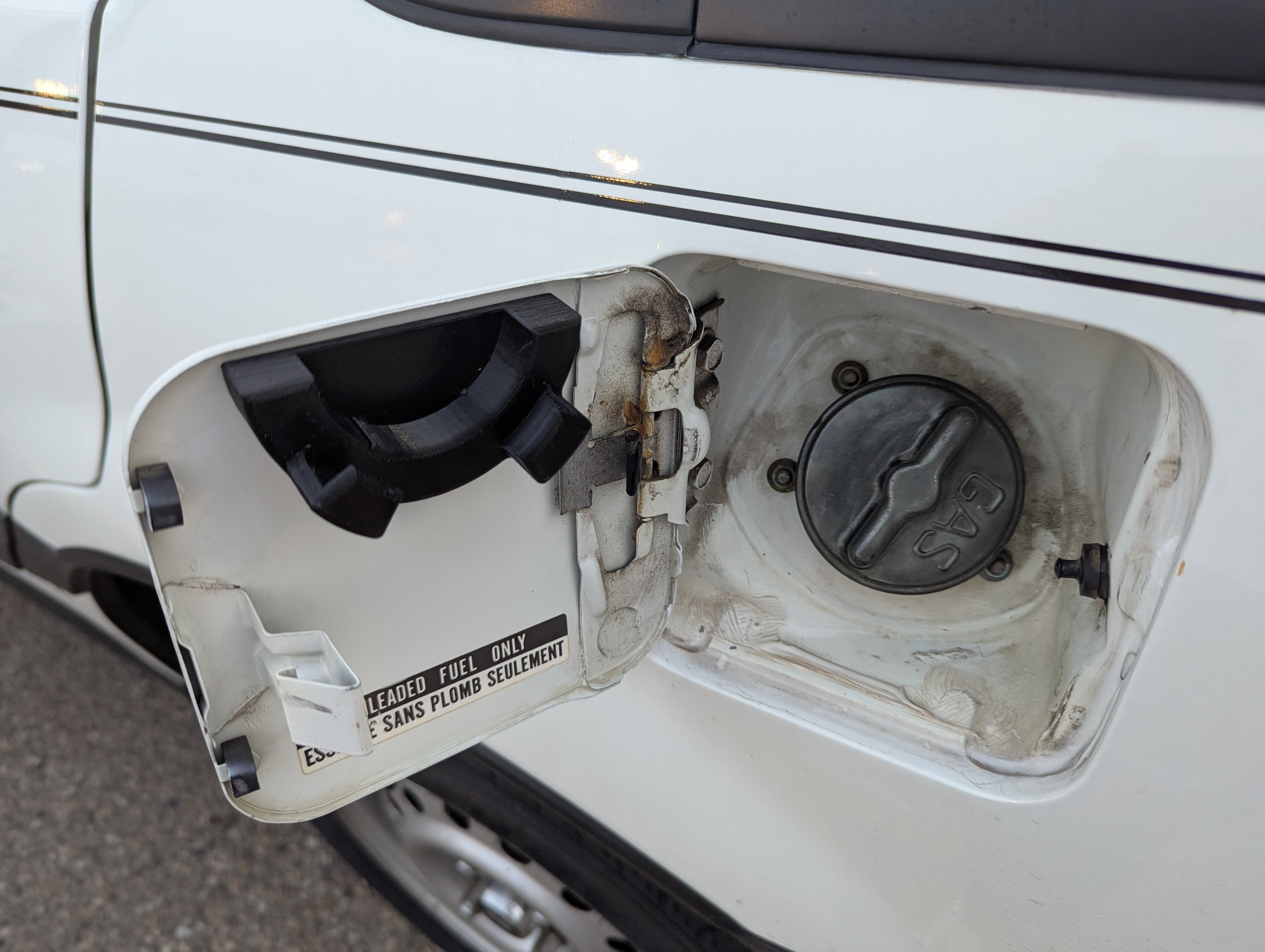

    • here is a 3d printed gas cap holder i designed myself. this is the only place on the internet im posting it. so i will find and kill you if i see it on etsy or any re-seller. please link back to this forum for others.

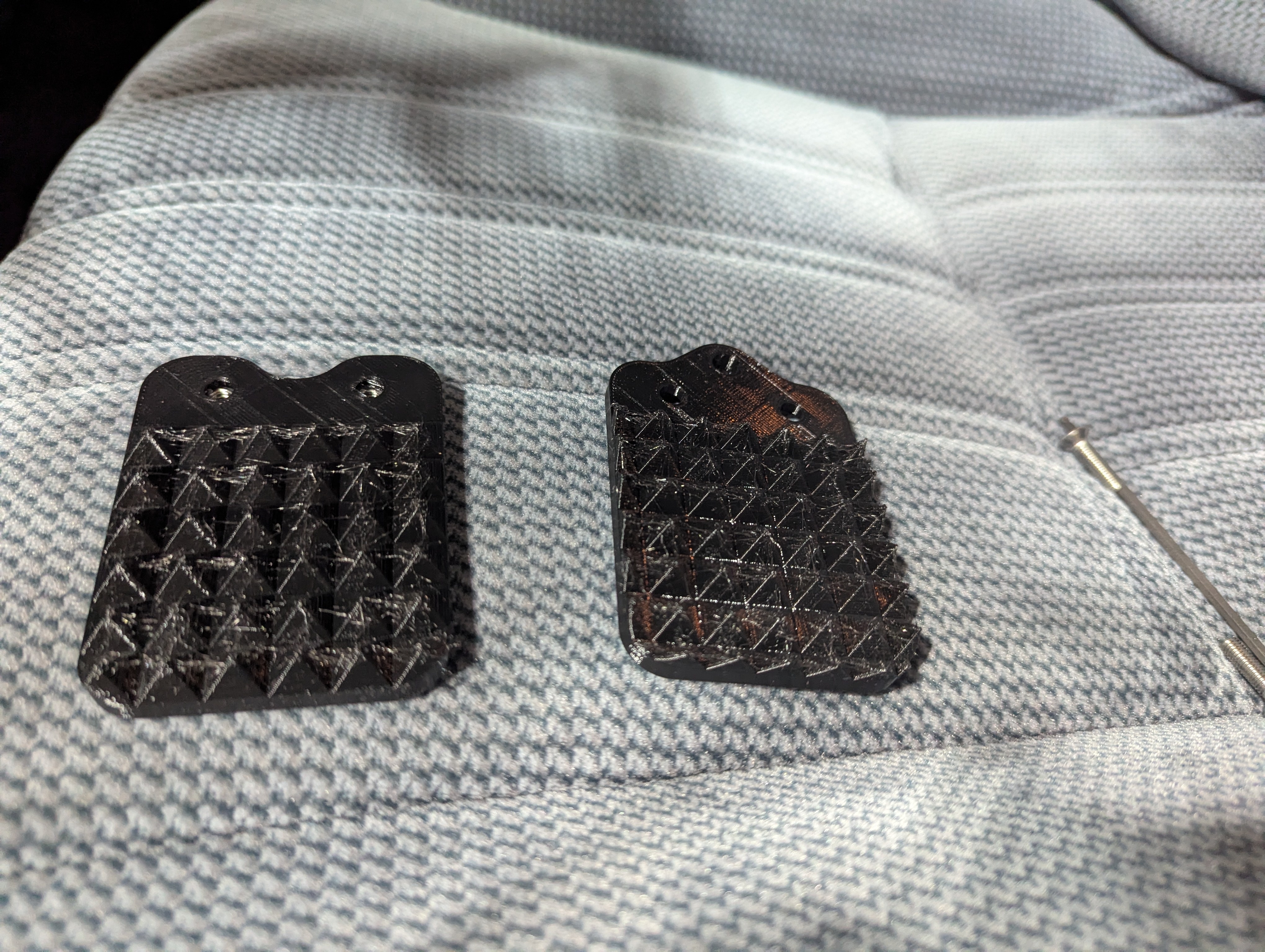

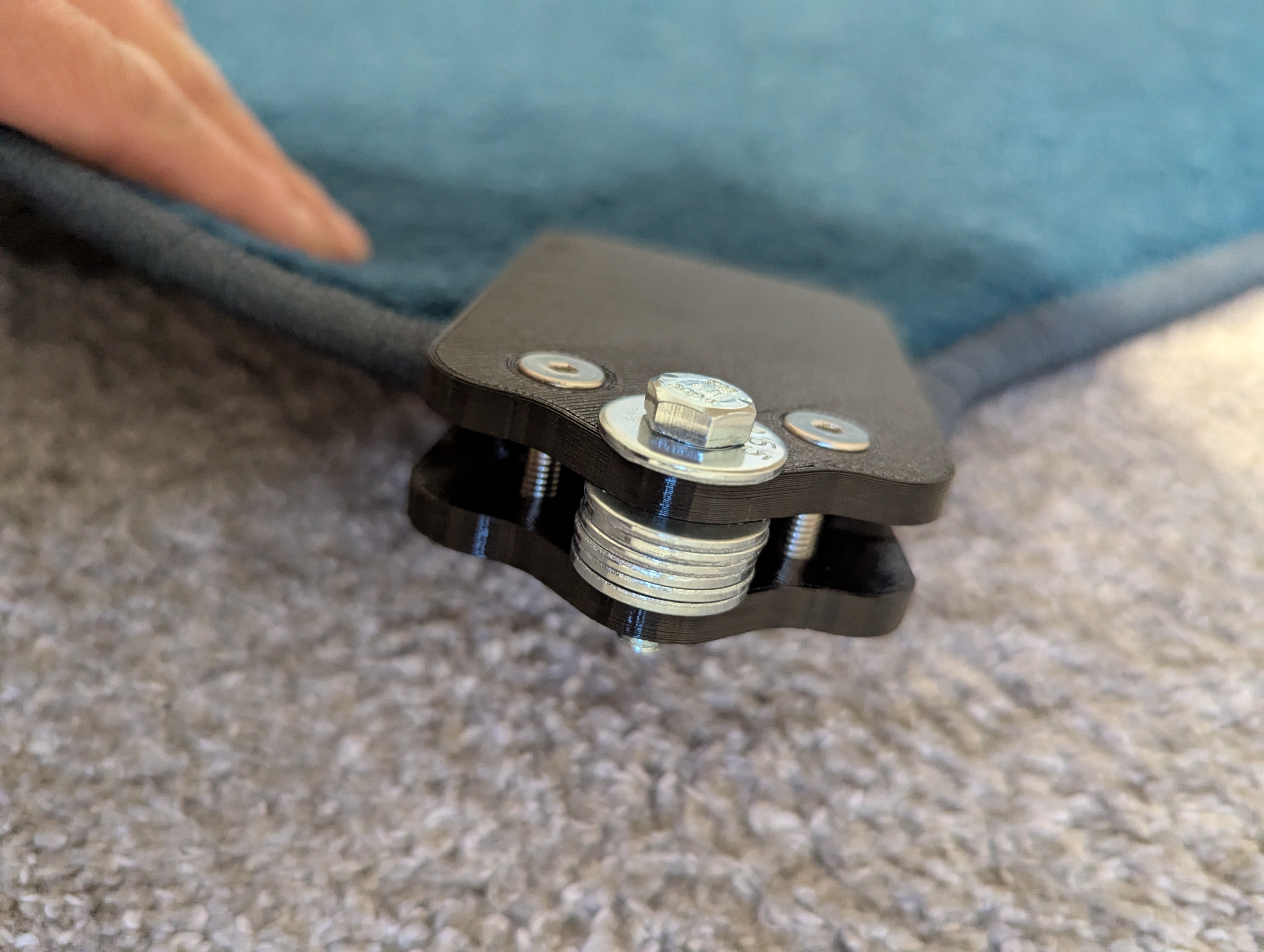

    • here is a carpet holder i designed to prevent the carpet from sliding forward and getting over the top of the tires. it reuses a bolt hole already in the frame, i have no clue why its there but i re-used it and its in the perfect spot. this is underneath the drivers seat.

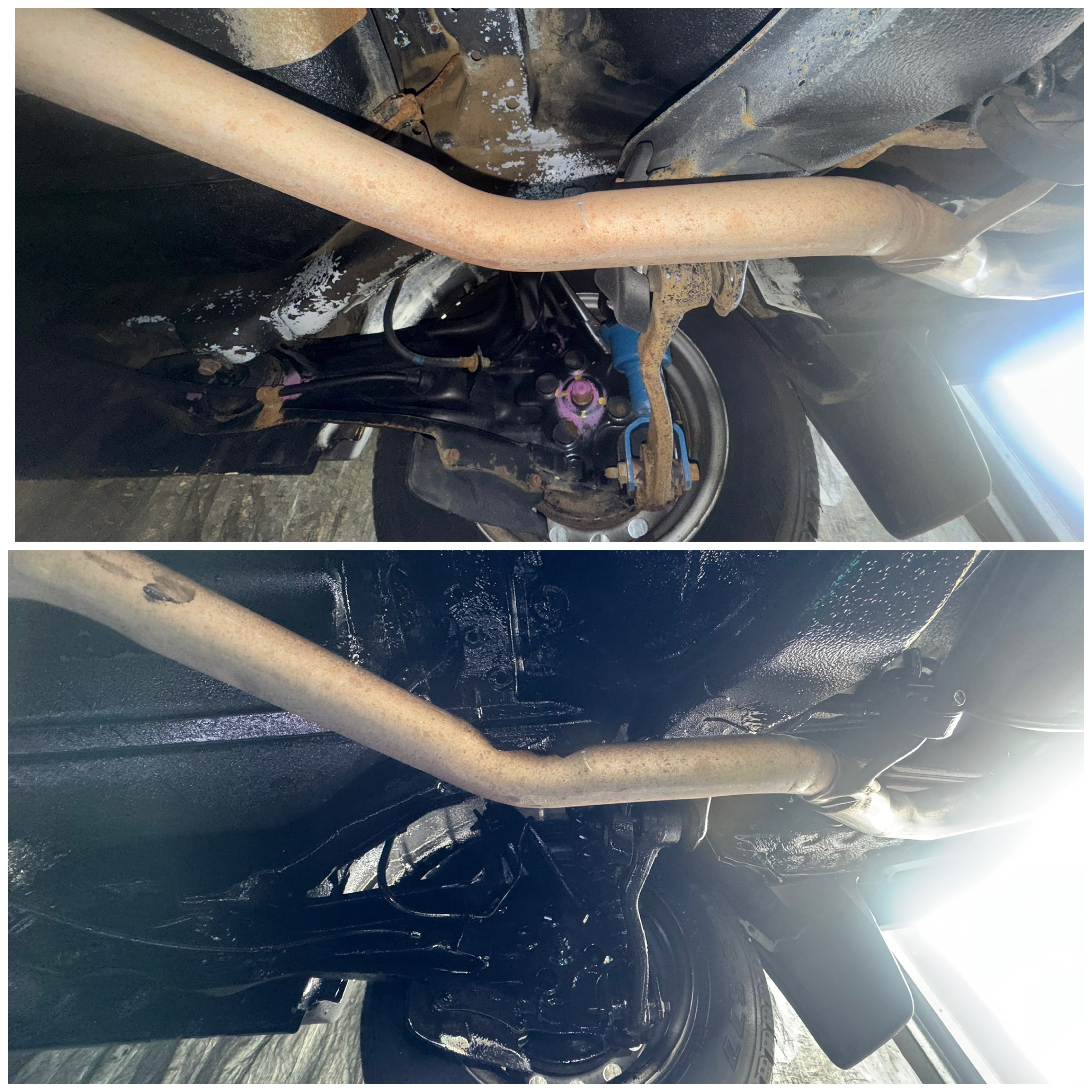

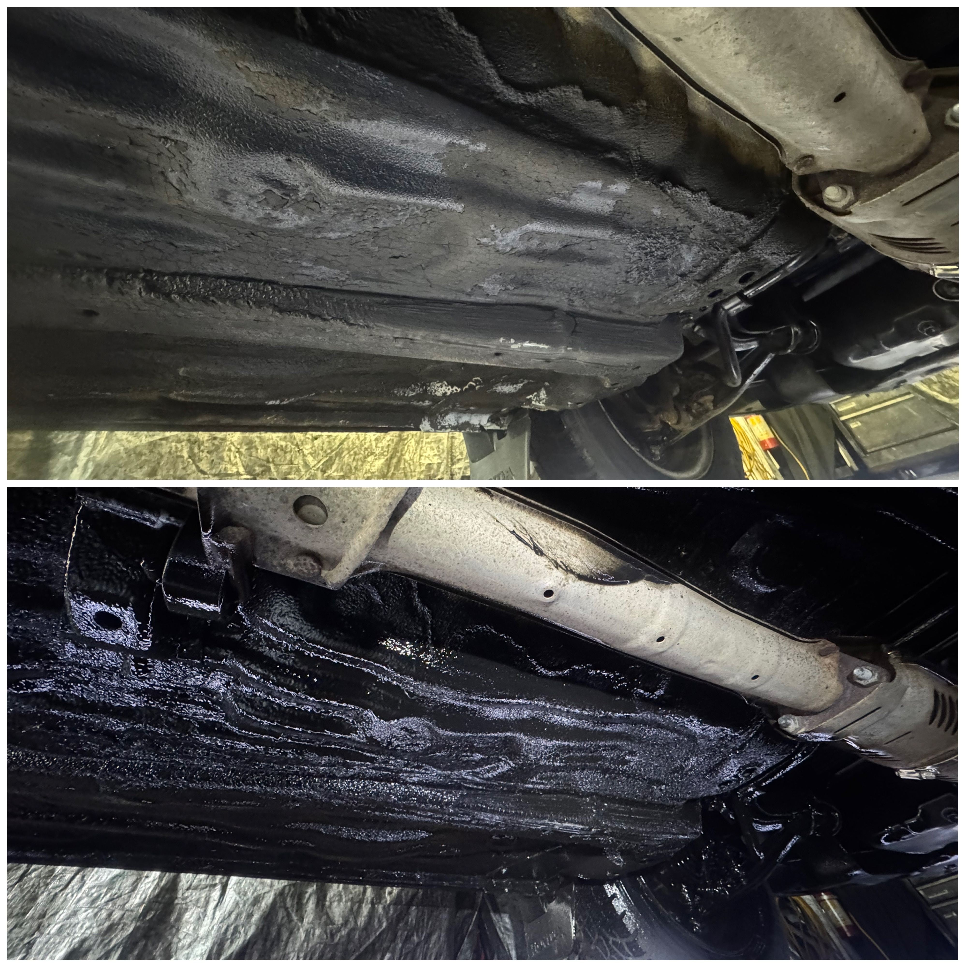

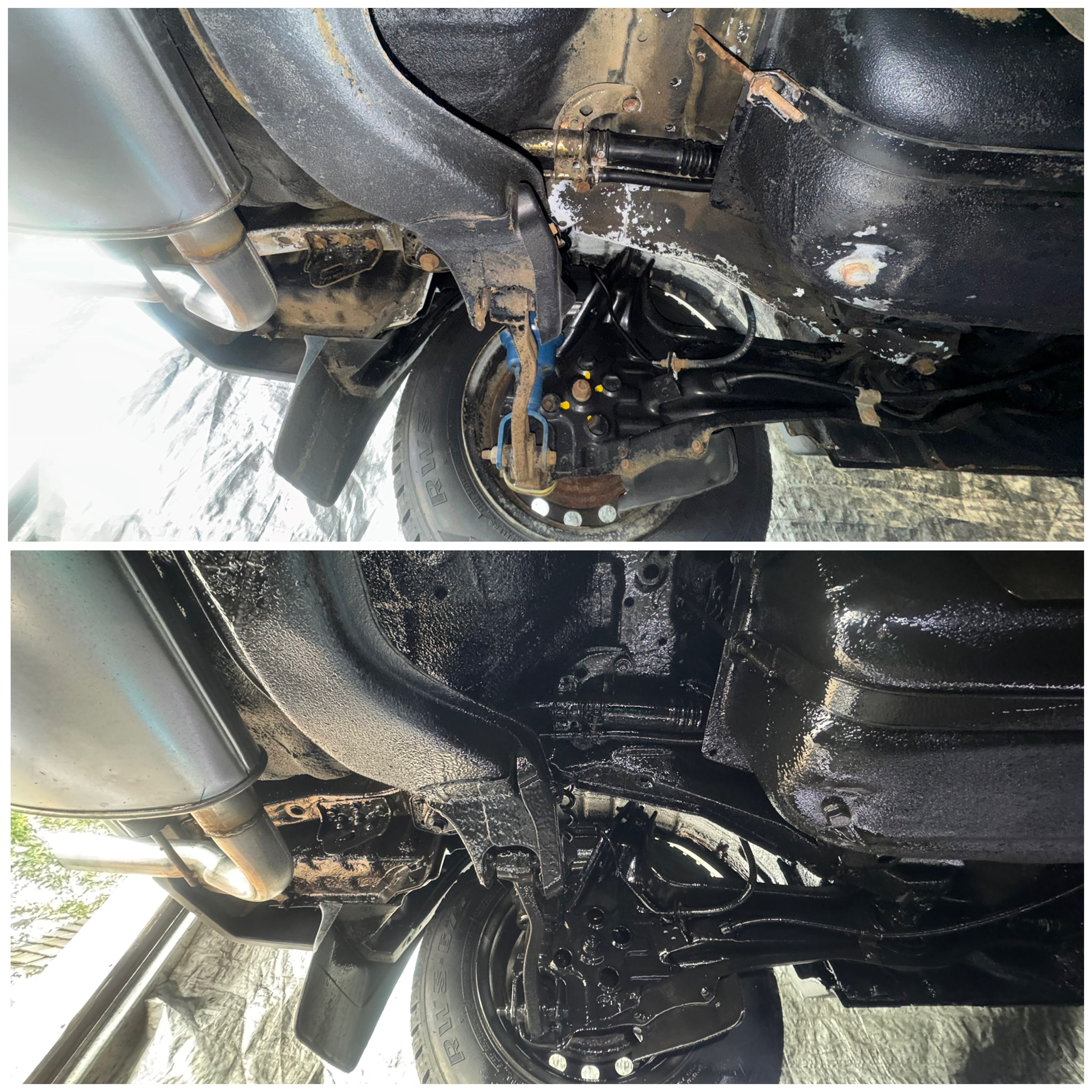

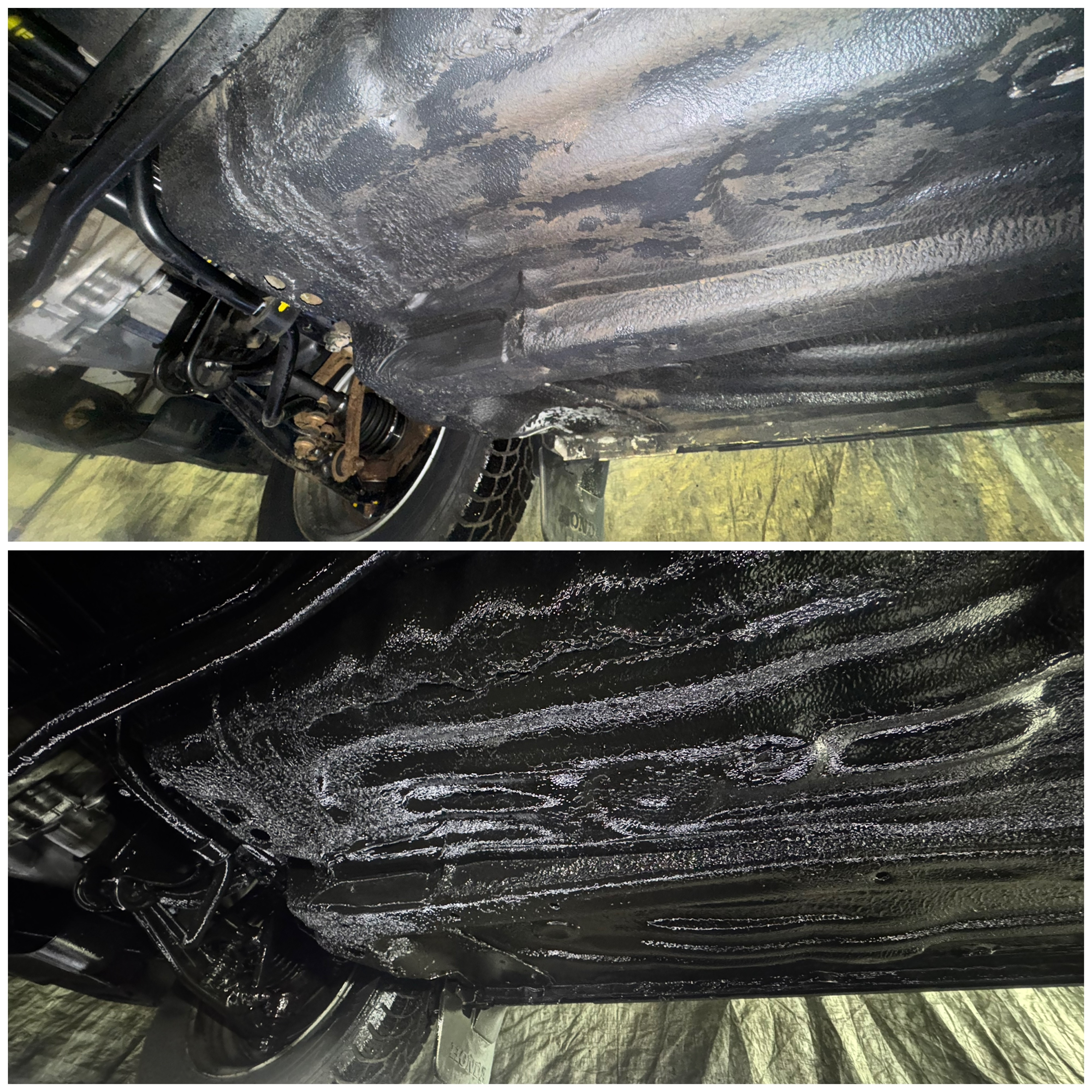

  • here are some pictures of before and after under-coating. the car was in pretty insanely good condition for its age.

    I didn’t even think about rockauto for carpet, I need to check that out soon. I also have those cup holders in my wagon (who ever owned in life installed them before me). I’ve seen couple Companies/people in the States have made those fuel cap holders past years.
    The carpet holder is a good idea to have that’s one thing I dislike is when my carpet moves. That’s one thing I need to do is the complete undercoating that’s definitely a must if there’s salt on the roads.
