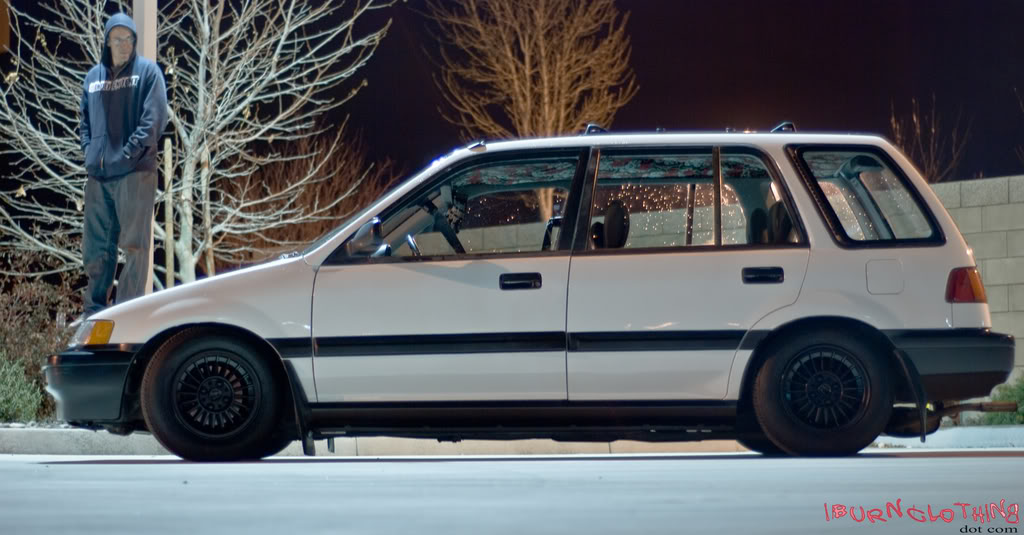

    so still been a while since i updated. don't have pics of the front lip up yet, you can see the rear lip on the contest on iburnclothing.com. but i figured i'd give an update. blew the motor last weekend. broke the cam in half. picking up a d16z6 this afternoon for transplant.
  • genedaddygenedaddy Wagonist

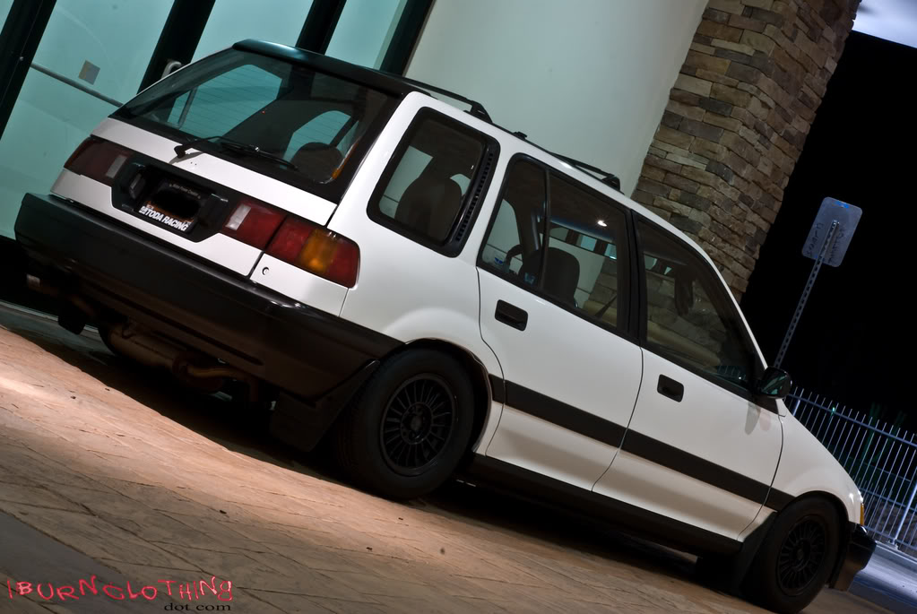

    so i found a pic of my car on wiredonhonda.com, it shows my front lip. for better resolution go to their site and look at the gallery. and remember to vote for the wagon on iburnclothing.com!
    enjoy

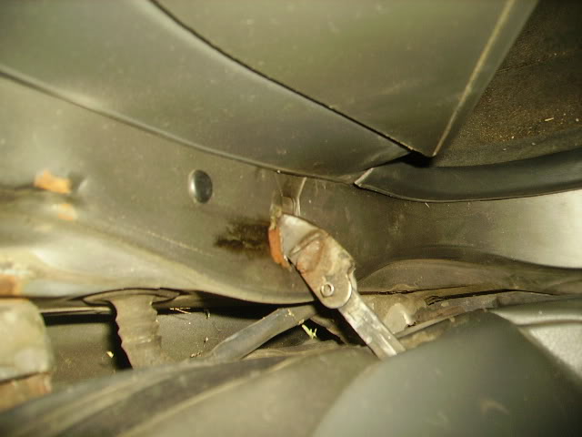

    Qdog wrote:
    Hey I have the exact same problem with my door! I wonder if its more common? Congrats on the wagon!
    My driver door is exactly like that. I guess the wind got ahold of it and broke the mounting point for that hinge or something.

    wagodizzle wrote:
    very common. even rust free wagons have this problem... including me :x
    me too!!!!!! :(

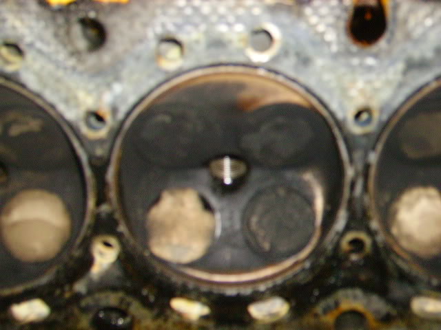

    well, i snapped the cam on the stock motor, and the rings were already toast so i decided to swap in the z6. also picked up a nice little hmt turbo kit for temporary use till the newest motor gets built :mrgreen:

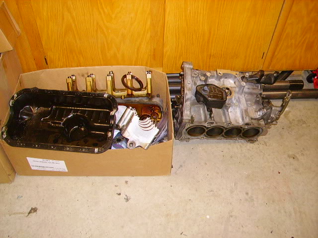

  • motors pulled apart. vitara pistons and eagle rods going in

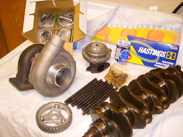

  • been busy, lots of of stuff going on lately......replaced the front spindles and put on a camber kit, got the powdered forks on. the bottom end of my engine is now rebuilt, eagle rods with vitara pistons, acl rods bearings and king mains, arp head studs to hold the head down. also added some new shoes. here's some pics
    powdered valve cover, white with black speckles
    block all cleaned and painted up
    new shoes
    spare home made turbo kit got laying around
