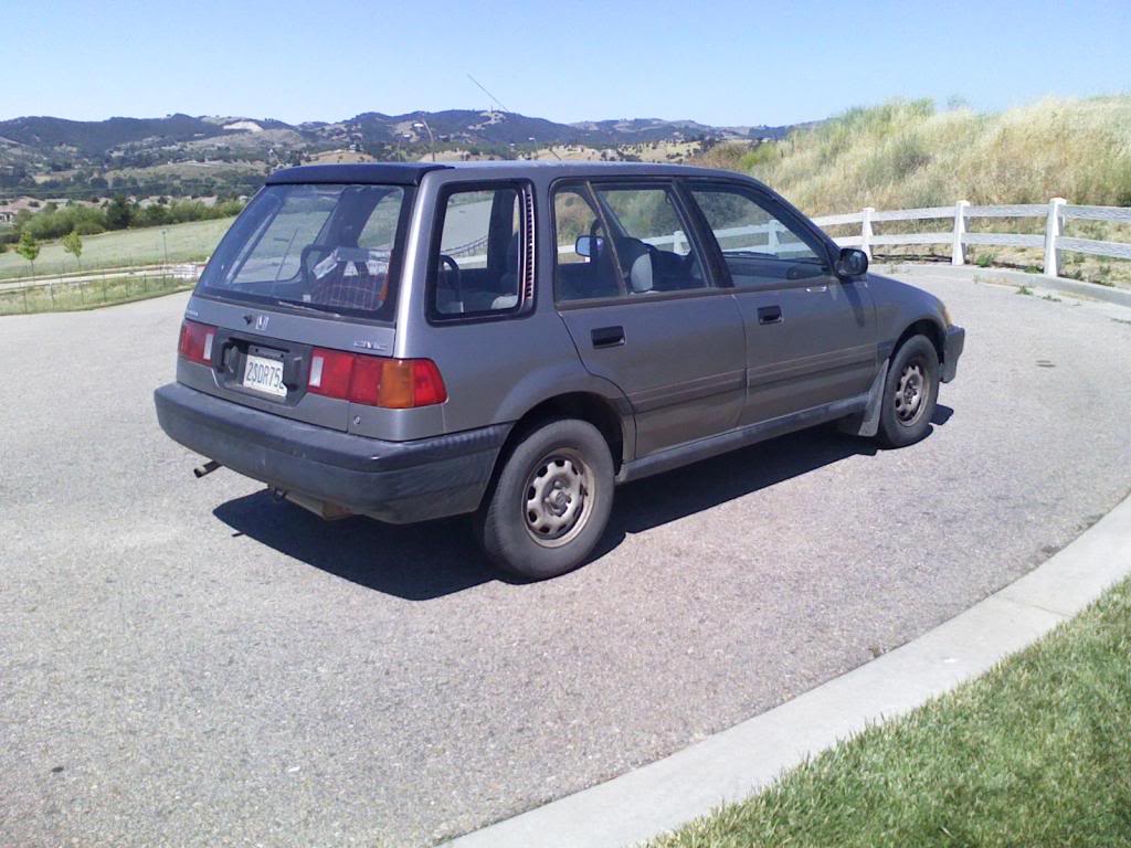

My 1990 S.L.O. build
this will be a long build thread so bear with me. slo being as i live in san luis obispo co. ha ha.
but slow as i have 4 kids, 3 dogs, and excursion (44gal tank), 99 civic, 92 gs-r. and 1 income.
so here's what i'm working with: 248k miles on it. "USED", Cracked windshield, carpet and seats trashed!
but scored some ef 4dr front seats for $50 in the process of modifiying the seatrails to make them fit.
then gonna tear the entire interior out and CCLLEEAANN IITT! hopefully i can save the carpet because i was looking around and everyone on here says there is no-one who sells a kit like the one i got for an old teg? (company name was acc). and just ran into an old buddy who has a crx laying around + motor parts yeah!
so wish me luck...

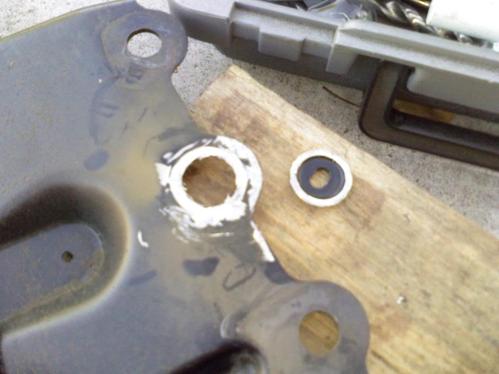

the inside rail just had to open the hole a little bit.
the tall outside rail needed a little more modification.
1- cut dimple off
2- cut top of rivets on front little bracket (used up i good fiber wheel and 6 cheapo shatterwheels)
3- grind pegs so when you move bracket it uses the studs left
4- drill holes where the there are none
4a-paint grinded and drilled areas so it don't rust.
5- install short bolts (10mmhead & sparkplug cover nuts so they clear rail when it moves.)
6- open up / slot holes on the two larger boltholes (12mm heads)
7- the wire that adjusts the seats forward and backward had to be lengthened a little bit, real easy just take it out and re-bend it where ya need it and slide that little washer back on. forgot to take pics of that, sorry.
8- install seat, ya might have to finesse it in and adjust back and forth until all the holes line up
9- make sure you plug in the seatbelt plug under the seat or the binging will drive you nuts!
