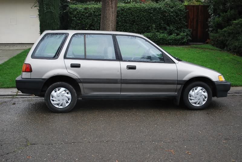

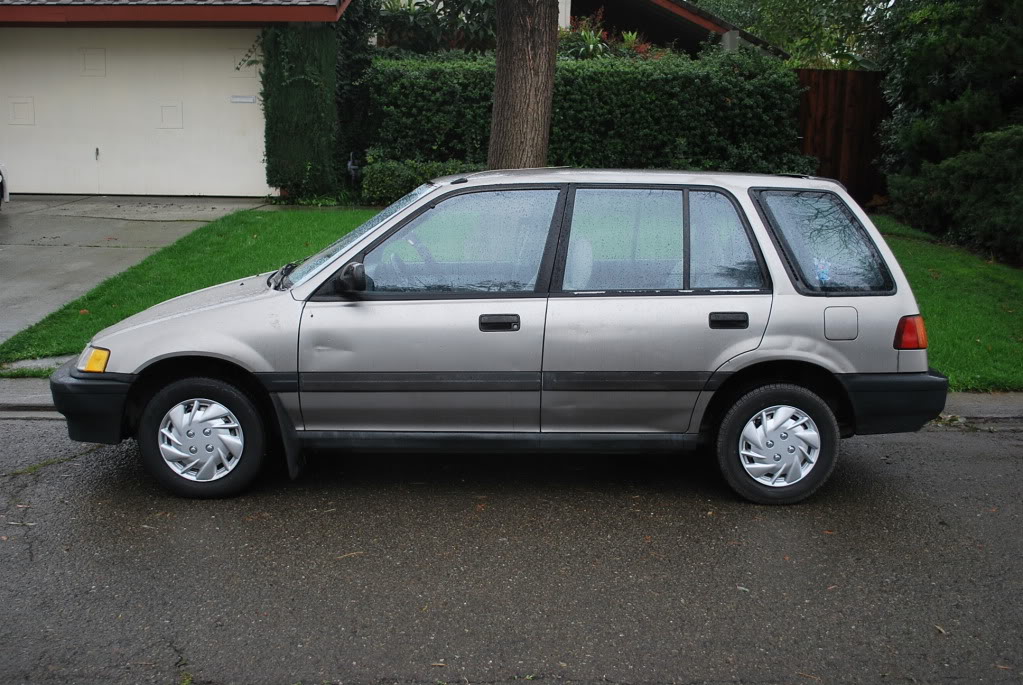

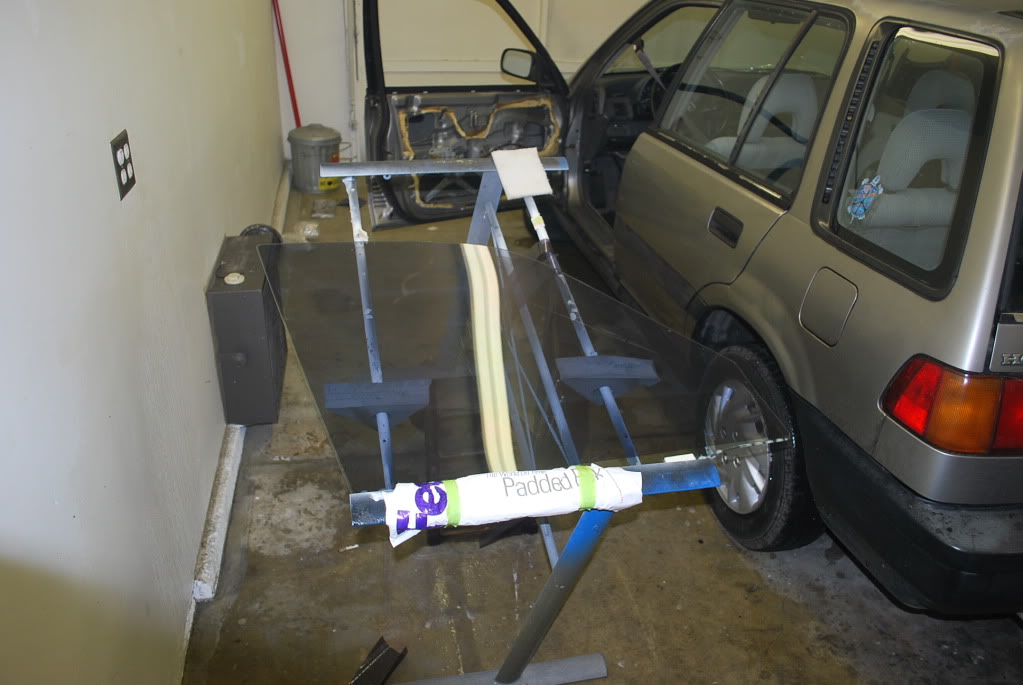

                    I've been looking for a wagon for a while and came across this gem. It's almost completely original. It's never been wrecked with all factory paint. The plan is to keep it as stock as possible.
Yea, I know. I guess I just want to keep it stock looking. Maybe some wheels. The struts are original and need to be replaced. I guess if I'm going to do those I might as well get some lower springs....

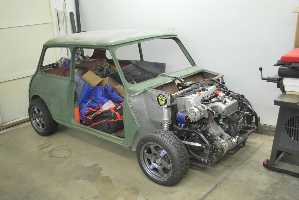

Not mine, but here's another swap being built in my garage.

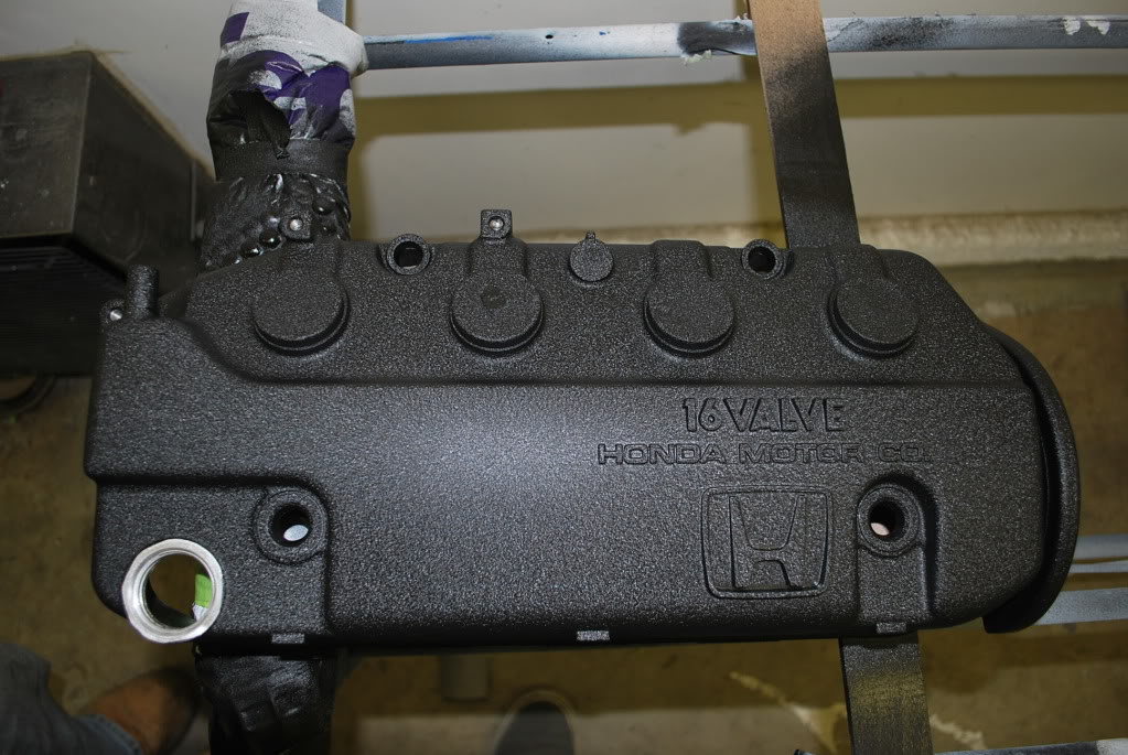

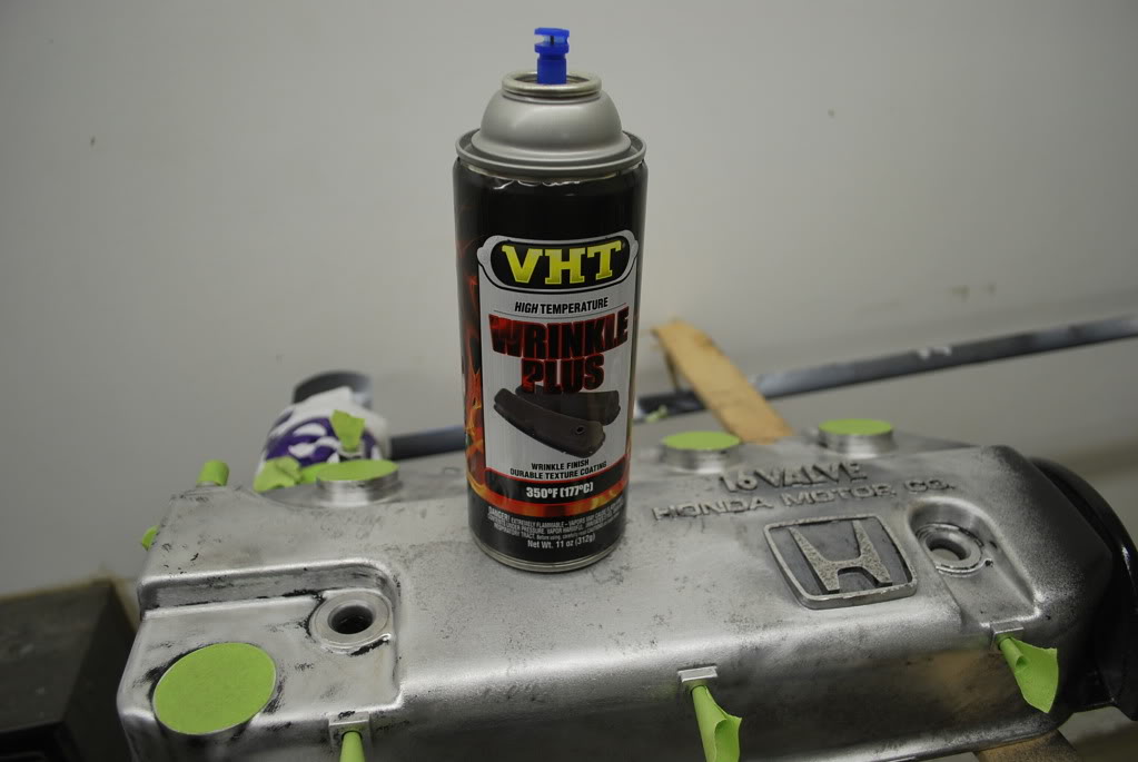

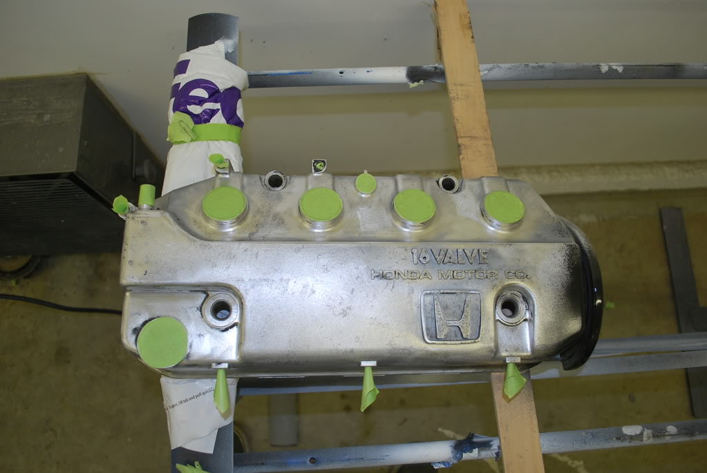

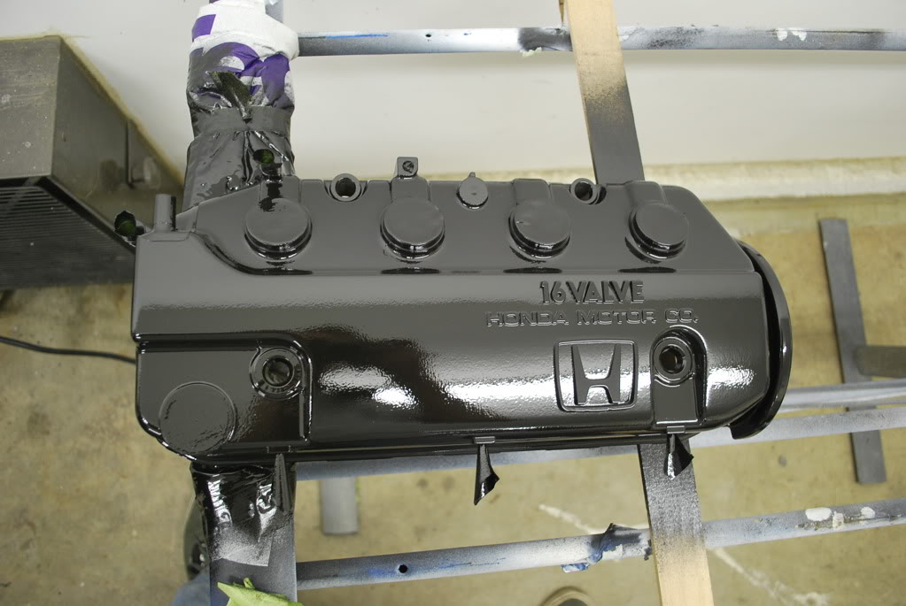

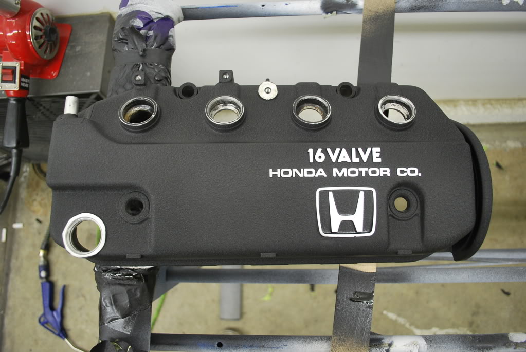

X2, I like how clean the valve cover came out. Do they have that paint in other colors?
I've learned with the wrinkle that if you hit it with a heat gun immediately after the last coat the wrinkle will be smaller and tighter.
