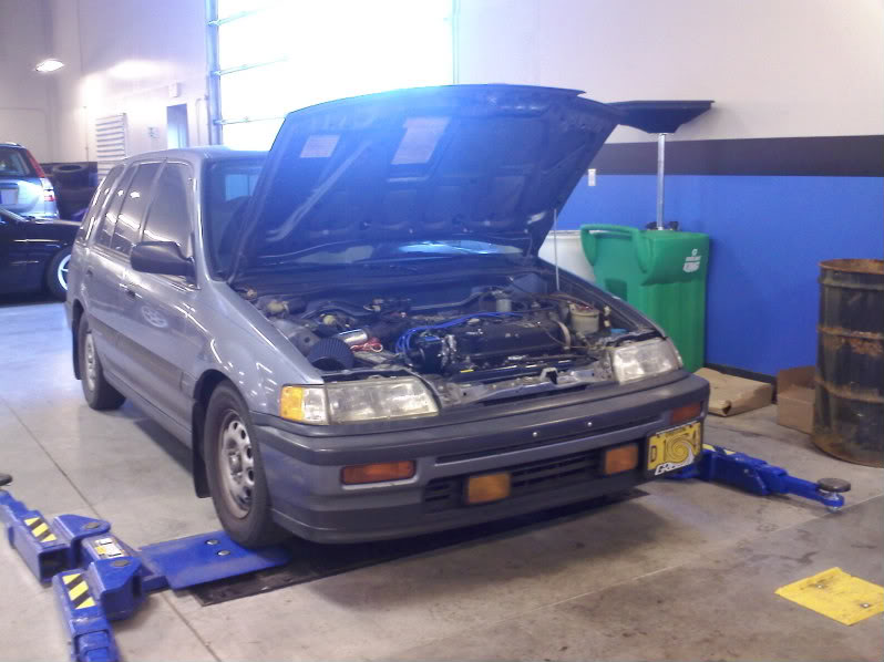

Since I couldn't find a plate relocator anywhere I decided to make one. All I did was take some measurements and kinda draw it out on some graph paper. I made a to scale drawing and cut it out, transfered it to a piece of 1/8 inch aluminum. Plasma burned it out and belt sanded it all smooth. Tapped 2 1/4-20 holes and made a 3/8 slot and it was done. Enjoy! I do still have the template if anyone wants a copy to make their own.
Here it is
Here is the bolts I used to mount it
Here it is mounted
(Yeah I know the paint looks bad, my trim paint has been sitting to long)
^^^^ You can see where you have to trim the bumper at in this picture
Finished Project
It turned out pretty good for about an hour of work. It does push up the bumper lense some but once I get a grinder I'll make a little indentation where the lense goes. It does stick out farther than I wanted but at least it doesn't rub on the bumper. You do need to trim the bumper slightly so it it sits flush with the lense "bucket".
