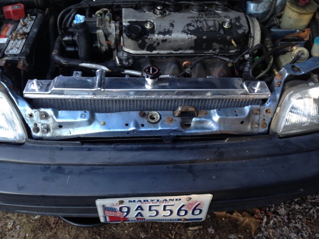

so after a good long cry in the shower i think i may have a solution...
i think i can simply shave the fan mounts off the bottom half of the radiator giving it enough clearance to go down and seat properly. Due to the size of the radiator i don't think the stock fans are going to fit regardless so i believe there are some slim fans i can get aftermarket that simply mount through the fins? (i'll need to shop around)
tell me what you guys think!
Are those fan mounts on the front side? Mine were mounted to the back. Yeah I'd shave off that widget there at the bottom, the first pic is exactly how my radiator was sitting when I wasn't getting clearance due to the thicker fans.
Yeah based on those pictures, there's not even supposed to be that little mounting bung there. Rat bastards, I'd knock that off for sure, that's likely the majority of the fitment problem right there.

grinded off the bottom tabs, installed slim fans, and she slipped in perfect. Had to improvise on the top rad hold downs but everything went on smooth. Very happy to have my wagon running again especially in this snow storm!
I hate snow.
You may want to shorten your upper radiator hose tho. About 2 inches off the engine end should eliminate the kink.
