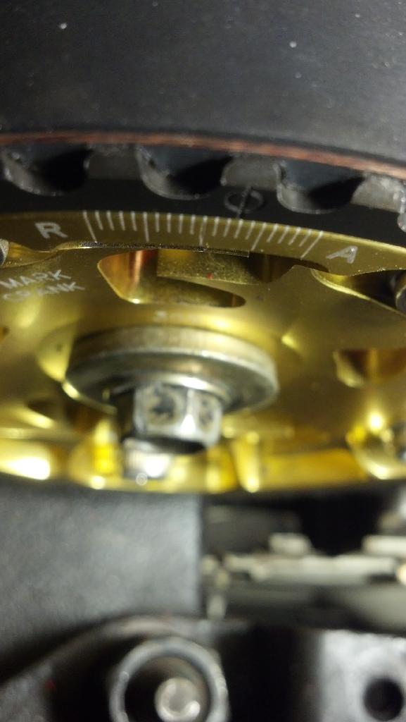

I've since then advanced the cam gear almost 5 degrees... and it looks like this..
I still need to finish some little things before I can put it back together and start it so I can check for codes again. I'll update as soon as I can in case anyone is interested
