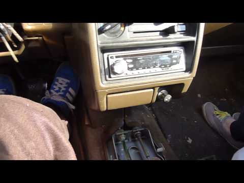

There is a small set of videos linked together. I don't know how to make it show the series so the link below takes you to them.
[video]
