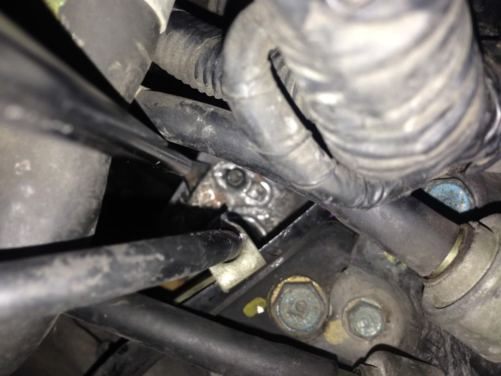

To tow your RT4wd wagon, or drive it in 2wd, you need to disengage the transfer gear. Having fielded this question twice in a week, I thought I'd try to explain how with pictures.
In this picture the orange lever is the one you need to move. The tube sticking up in the crook of the lever is the speedo drive. If you follow the speedo cable down to the trans. You're in the right place. With a 10 mm wrench or socket, loosen the lock bolt located in the curved slot. Then use the same tool to rotate the arm to the other end of the slot. Then retighten the lock bolt to hold the arm in place.

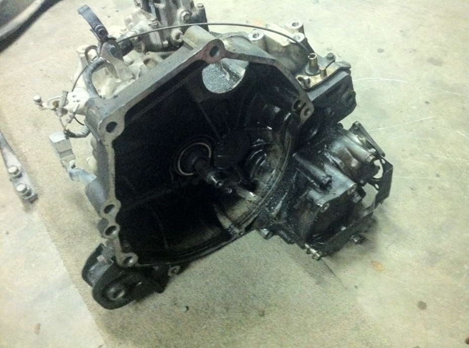

an automatic RT requires the same precaution, but the lock lever is accessed through the right front wheelwell. Follow the cv axle to the transmission, the lever is just below the axle hole. This picture is of the only auto RT trans I have laying around. Crusty, but you get the idea.

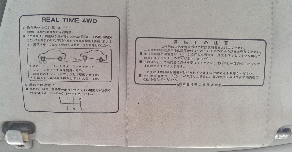

Only thing is teh manual and the sticker under the bonnet says for temporary use only.
