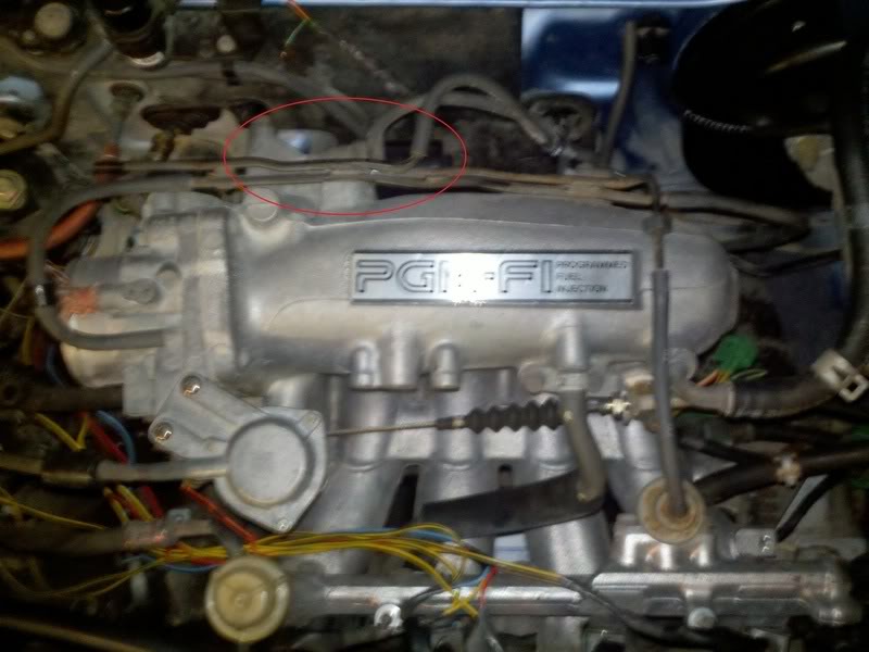

(and everyone says to extend the wires to the map sensor on the back of the b18 manifold)? can you take some pics and what intake manifold and throttle body are you using?

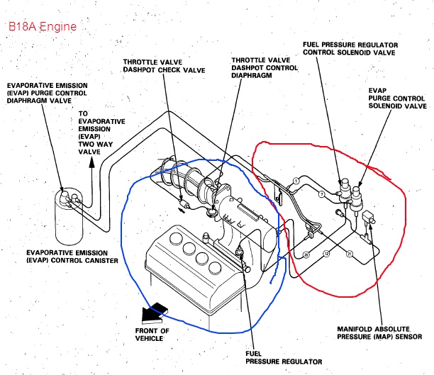

See that black vacuume hose coming out of your throttlebody? That will connect to your map sensor. re use the D series one afaik the obd0 ones are the same

You need to use that MAP sensor.
