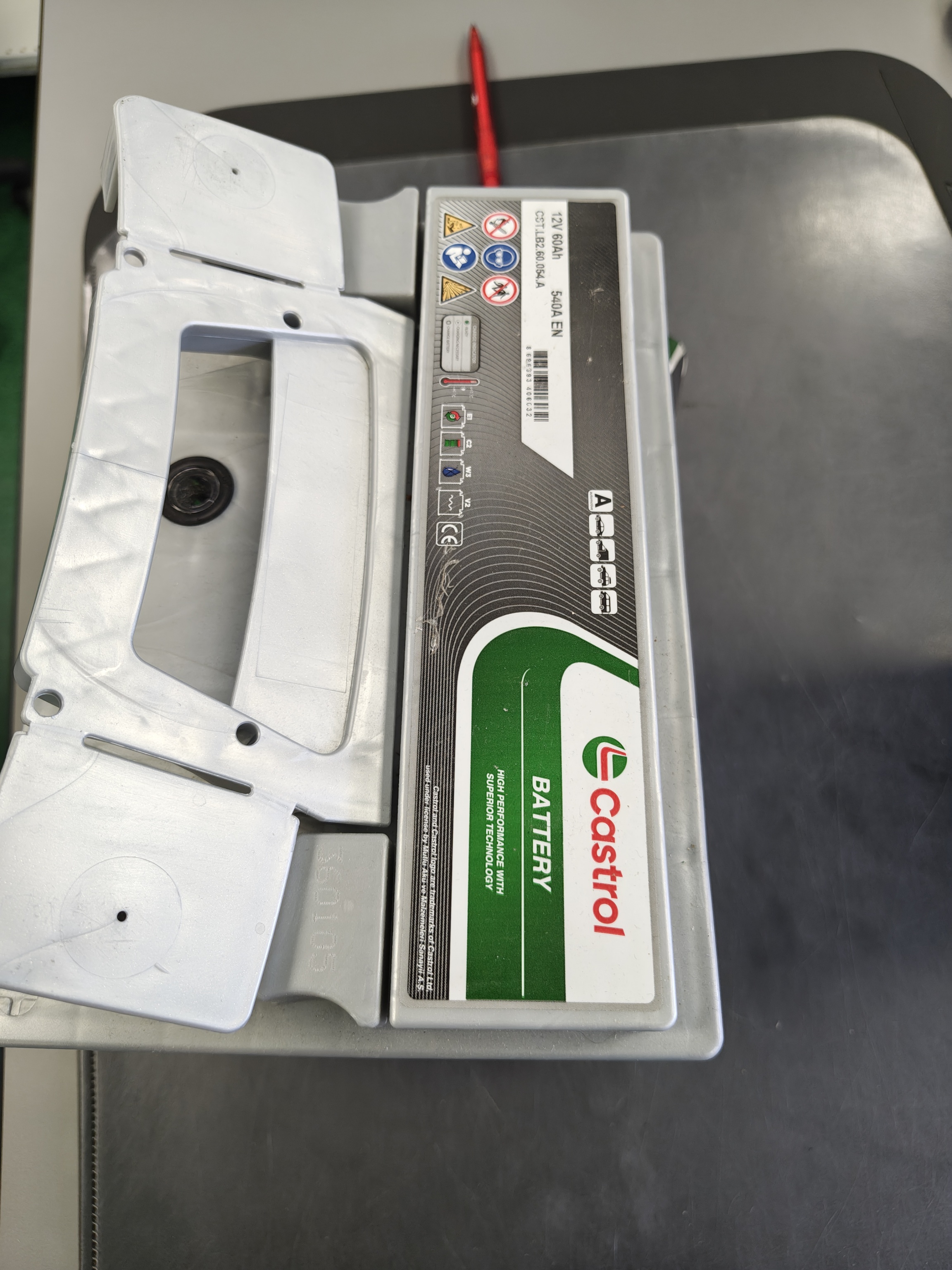

    • New Castrol battery with bigger capacity installed.

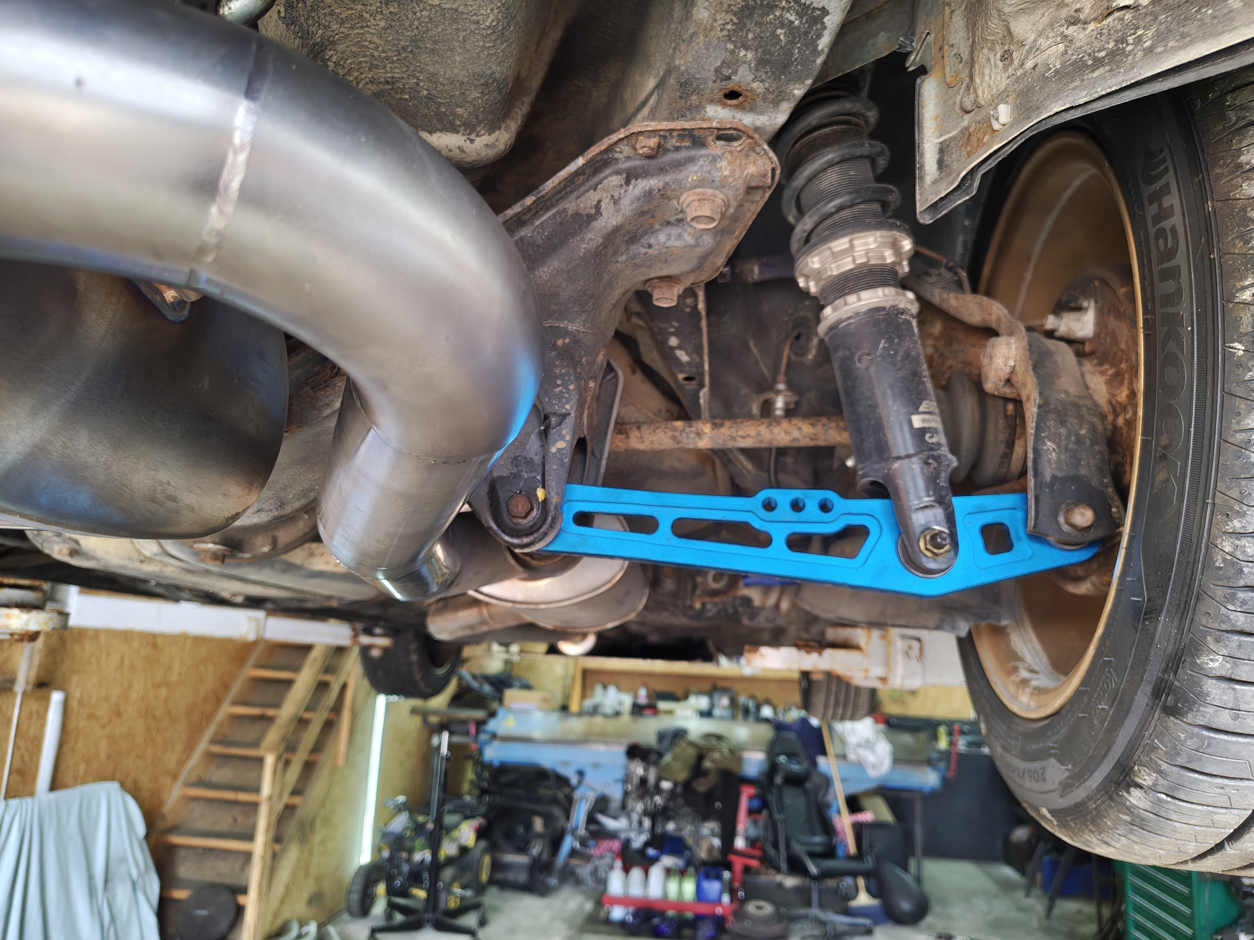

    • New rear LCA arms with hardened rubbers.
    • New rear adjustable Toe arms with hardened rubbers.
    • FINALLY got what I consider a perfect geometry set up for the wagon:
    • Front camber -1.5 each, total toe-in +0.10. Rear camber -1.0 each, total toe-in +0.15
    • The car now is more stable and rides better then ever before, highly recommend doing this!

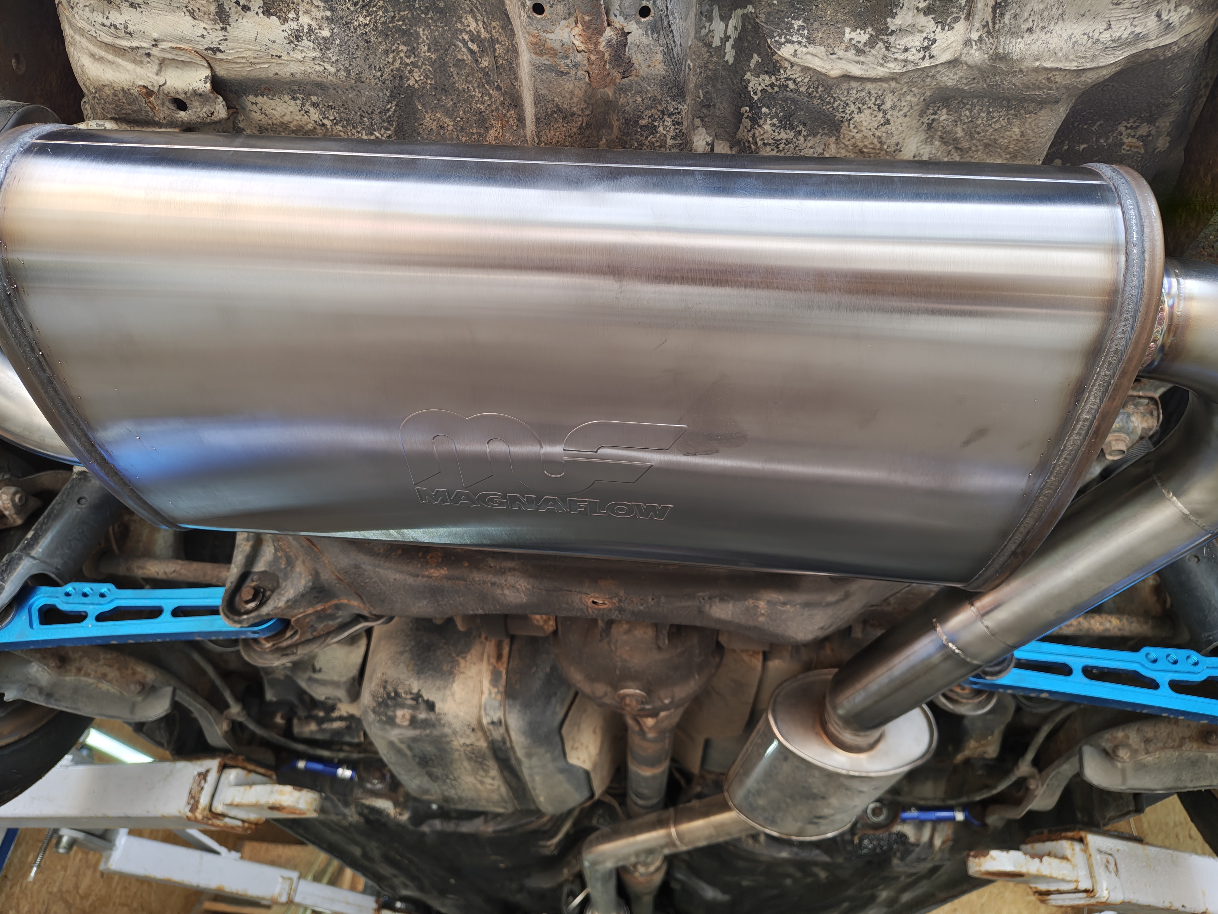

    • Got a BIG new Magnaflow rear muffler installed, and the damned low drone at 2.5-3.5k rpms is gone!

  • Great update, you’ve done a lot done on the list. That exhaust looks super clean and the welds looook incredibly
