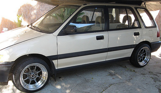

Ok so here's the update sorry got sidetracked.
First thing we changed was the muffler hard to see but you could kinda see the tip and bottom are new. Also you can see how clean the interior was when we got it.
Saturday Morning went to buy the rims and Coil-overs, had no clue what to get since we saw so many nice wagons on the site with different setups. We decided to ask the advice of the guy selling the rims, so we got stuck with;
16X8 XXR 002 Tires Neo Gen tires 205/40/R16
Before we got started on the suspension we took some pics of the car, you can kinda see how clean the car was kept up.

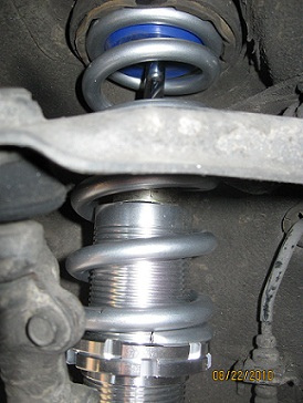

After we finally figured out how to remove the struts and coils
After installing the Coil-overs, by the way we did best we could with o rings and installation since it had no manual.

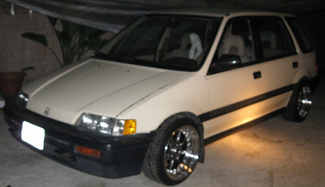

After installing the Coil-overs and rims, before adjusting them.
After adjusting the springs at the lowest point

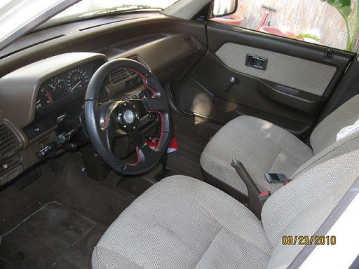

Changed the steering wheel
Also we had the fenders rolled before we changed the coils, well we were told that with such an aggressive set of tires we should have the fenders pulled as well. Well this was news to us since we explained to sales guy what type of look we were after where we bought the rims, well after the guys rolling the fenders said they would not be responsible for waves on the fenders we said just roll them.
Were not really sure if we might end up going with different rims later, in the mean time we might have the fenders rolled and find a way to go lower and camber the rims a bit.
