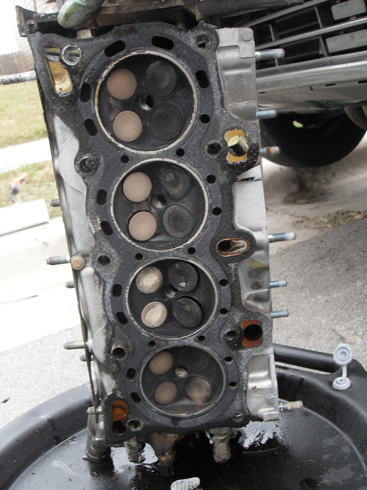

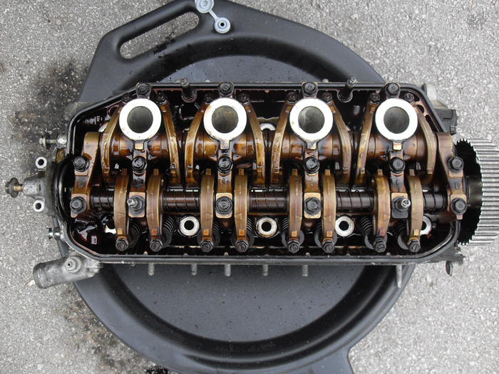

I've been doing tons of research. Been slowly and carefully tearing down the head over these past two weeks, and by the looks of it, I think the gasket is indeed what failed. Got a little rust on the #4 cylinder, and the gasket is as hard as a rock (and super brittle when trying to peel it off). It's toasty!
So toasty in fact, it's cemented to the bottom of the head.
The block seems fairly decent given the abuse it saw from the previous owner, but the head has me worried. Lots of corrosion on the valves and... what's the term... that orange film build-up on the top where the rockers are. But that should be remedied by the machine shop, right? I found a local place that will clean the head and then check for cracks for $45, and if it needs to be machined, another $45. Sound reasonable?
Once I get word back from them on the status of the cracks (or ideally the lack thereof) I'll move on.

Oh! And one last thing, I did notice some odd soot buildup on the #1 and #4 intake and exhaust ports. (I think they're called ports? Where the manifolds join with the head, I mean.)
Exhaust with the gasket removed:
and intake (gasket is stuck on the intake manifold), below:
I never heard any kind of... what's it called... "blow back" I think? (When there's a loud pop sound coming out the exhaust?) Anyway, whatever that symptom is called, I have not encountered it. The car has run perfectly fine up until recently in that respect.
It's a bit odd that the middle two ports are so clean in comparison, though. Don't let that darkness fool you-- that's not a shadow. Its caked on carbon!
Naaaaaaaasty!
Anything to be worried about?
