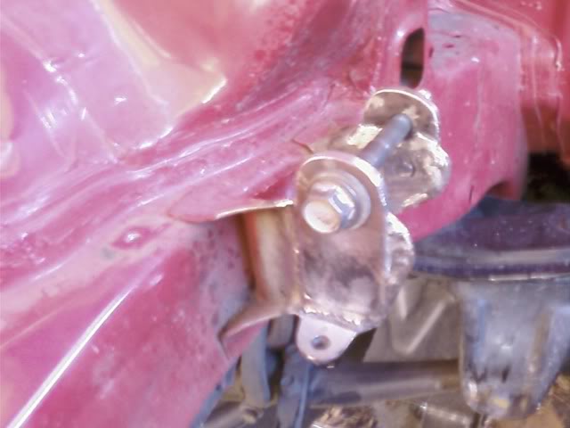

I will stick to my guns on the whole mount story: the piece that is spot welded in the engine compartment on the right side frame rail just above the transmission is specific to the manual transmission RT4WD. All the other models of Wagons have the same mount (FWD manual, FWD auto, RT4WD auto). The RT4WD manual has its own piece. I have bought a chunk of the frame rail at the wreckers that includes the special mount, then drilled out the spot welds on my FWD chassis, as well as the spot welds on the chunk from the wreckers, and then welded in the new piece. It just needs painted now.

There are other ways to do it, like this:

The top picture is where you cut the actual mount out of a RT4WD, and removed your factory FWD mount, to weld in the RT replacement. Correct?

If you chose the other method, the only concern I would have is that you will have to shave some metal off the bottom of the OEM mount, as the rubber mount bolted to the transmission comes up a little higher, and will probably hit on the bottom of the FWD chassis mount if you don't trim it.
If I can find the Manual RT4WD mount (say I find everything from a donor vehicle), then I will be going with the replacement method. It just seems like the "right" (vs. wrong) way to do it, and actually a lot more simple. Takes all of the measuring and fabrication part out of it.
